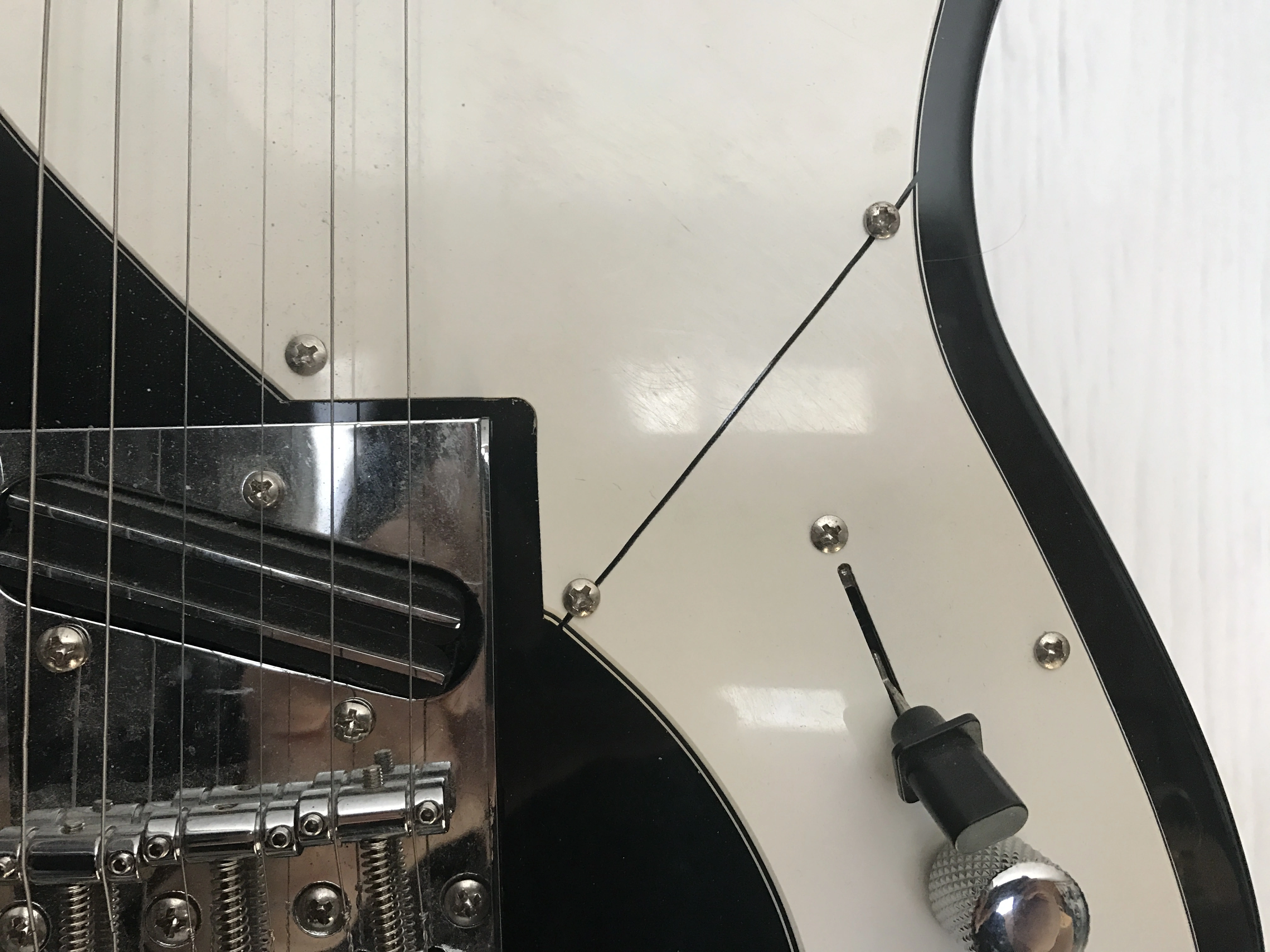

This doesn't help if you need to get at the pickup, but I have a long standing habit where the first time I remove a pickguard with the controls attached, I cut it to separate the control section before I put it back on. You can usually find two opposing screw holes and cut a line between them so they can hold both pieces and you don't have to drill the body to add screws. It makes it soooo much easier to fix/modify later.
This is on a tele, but I think it makes the point:
