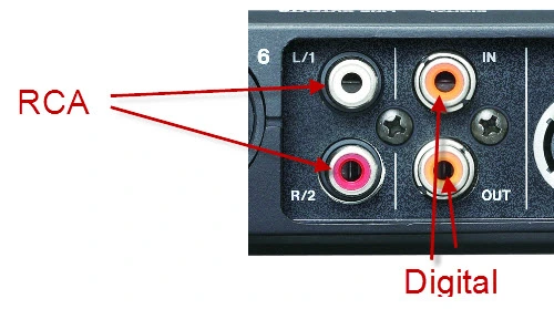

The back of your interface has 4 RCA connectors - two are the L/R analog outs and two are for digital IO (see below). Don't hook the digital connectors to you monitors!

The keyboard is the casio Wk-200. there arent drivers for it on the website, so ill have to wait until monday to have casio send me another one. But as for the cables, i have RCA/TS cables, but my tascam only has 1 set of RCA outputs, the other set is digital in/out. so does that mean ill need one cable to have the RCA left jack and one to have the RCA right jack?
Yep, you're exactly right there. Left goes to left speaker and right goes to right speaker.
Alright thanks. So just to clarify, on which ever cable i have plugged in to RCA left, the RCA right jack is just gonna be dangling there not hooked up to anything, and whichever cable i have hooked up to RCA right, the RCA left jack is just gonna be hanging there? Or can i buy 2 cables that each only have 1 RCA jack on them, one having the left jack and the other cable having the right jack??
ASG, the cable I showed you in my previous post is all you need - that is two cables in one.
You plug 1 RCA into the left and one into the right RCA outputs on the Tascam and each connector on the other end goes to a TS jack on the respective monitor - so all connectors on the cable are used.
