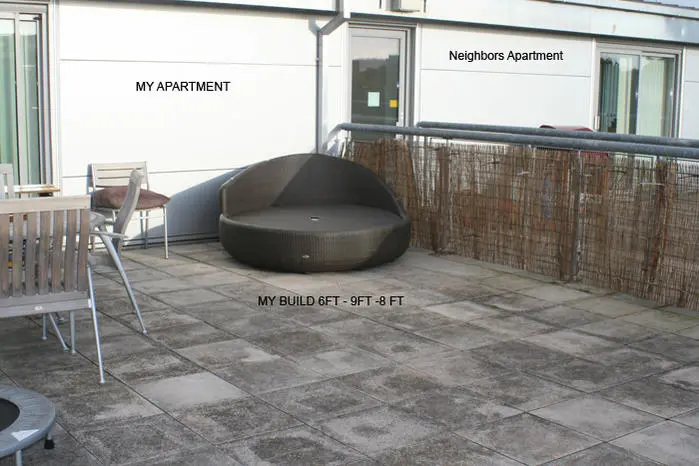

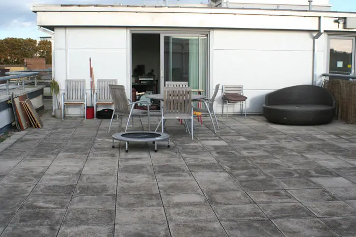

Okay. I'll try my best here to explain what I expect to achieve, where I'm building this room and why.
Please see attached photos of the space I will be using.
Internal room size 6 ft depth by 9 ft long by 8 ft tall.
I am planning to use a Mass-Spring-Mass type wall. The spring will be probably 3 inches. Like the Partition Photo.
I will be using a "FLOATING FLOOR" as I have neighbors below me. Also as you can see in the photos that is a neighbor just over the fence. I could build it right at the back of my roof terrace but I'm worried about the cables going that far as my control room is in the apartment. As stated before the roof floor WILL HOLD. I live with an architect who has approved it will hold and by a structural engineer. Also you can't see in the photos but my neighbor down the other end of the building has a HUGE hot tub on his terrace. His floor has not fallen through. I'm not worried about the floor at all. Sorry I just wanted to clear that up before I get blasted with comments regarding this.
I will be building this room to Isolate Heavy Rock drums from my neighbors below me and next door as much as possible. I will also use this room to record guitars cabs. I WON'T be using this room to have a live band play or anything like that. One instrument at a time. Also another reason for this build in regards to why I'm building it is that it's a good place to learn how to record drums without needing to rent a rehearsal space. Here I can record whenever I want. Obviously not at 3am. I'm trying to be as informative as possible so I apologize if I have missed something.
Also for my build I will be using 12.5 mm plaster boards. 3 for each leaf as 19mm is hard to find or way to expensive. Green Glue to stick in between them. No Resilient Channels and No MLV or Sheetrock. I hear it's a waste og money. The normal "Fluffy Stuff" for insulation. Myabe U-boats to float the floor but I'm looking into that. AC50 Everflex Sealant for all the joints. A double door system. I'm looking into the best options. NO WINDOW and I'm working on what to do for an Air vent. 2X6 studs not staggered. As few screws as possible. Like I said, I apologize if I have missed some vital Info.

I wish you all the LUCK in the world isolating rock drums from neighbours THAT close.
Looks like with the money you will have to spend to get them down to anywhere near an acceptable level you could buy something like the Roland TD12 and trigger BFD or DFHS 2.0. This is by no means a "crappy elelectic drums" setup and will give you drum recordings that will be much more manageable to get an acceptable sound than recording in a 6 x 9 sweatbox.
I realise we're in the studio building form here so I'll quit now with alternative suggestions. However, I suggest you start a new topic asking how many people have succesfully built a drum booth 6 x 9 on the inside no matter how much mass they have on the outside to kill the SPL and got results, and I mean good results where they are content with their drum sounds.
80% of the drum sound on comercial recordings IS the sound of the room they are recorded in. With a 6 x 9 x 8 drum room you will need to make it completely dead and add artificial room characteristics with reverbs and delays. This is not an ideal way to get a good drum sound. I won't even go into the problems you will run into with standing waves and mic phase issues in a space that small.
I'm sorry to sound so negative about it and hopefuly you will realise the sincerity of my post that I'm talking from past experience and trying to save you a lot of time, effort and wasted money. Do some more research. And good luck with your findings.

You're not missing anything, but more mass, more air-gap, being further from neighbours, etc. would all help.
People have done it, and it works if done right.
I have built a 9'x5' with 6'6" ceiling drum booth in an old world war(don't know which) bombshelter(with walls 3-brick-thick and concrete floor and roof). I lined the inside with plasterboard, and built an attempt at a "floating floor".
It's pretty well isolated, but you can still hear the drums outside. It's enough for what i need and, although my neighbours are close, they are not as close as yours, and i have a lot more mass. I've never actually asked them if they can hear anything in the house, but haven't had any complaints.
As for the sound inside. It doesn't sound great, and is really crampt(could do with an extra 1-2'), but i do have 4 gobos and 2 clouds. I get decent recordings imo, and would choose it over an e-kit.
That's a bit of relief pandamonk. Good to hear that it can be done. But remember I don't have to build my booth exactly there as shown in the photos. I can build it right at the end of the terrace which you can't see in the photos. It might help a little but worth a shot. If all else fails I can use it for guitars or vocals. I think it will work though. With a floating floor and a raised deck inside the booth for the drums like the one's aurolex make I can't see the neighbor's below me complaining. Also the neighbor's who live in the apartment you can see in the photos are pretty cool and are out most of the time. Monday - Friday they work 9-5 so I think things will be sweet.

But now I have two problems. If a snare drum being hit by a rock drummer is in excess of 120 Db most of the time and my wall is say an STC of 68, what can I do to improve the STC to get it somewhere like an STC of 90 or 100?
Make sure to float the floor on neoprene or something, and have the mass of the floor the same, or maybe even more than the walls.
