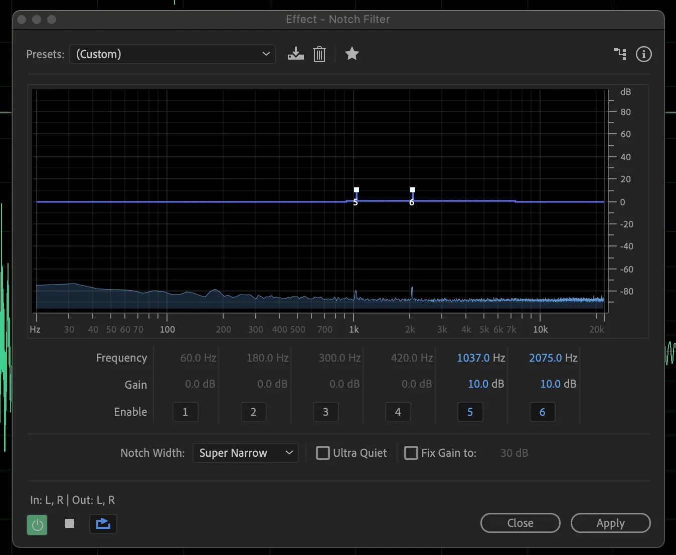

During the period from early 1998 to early 2001, I used my father's computer set-up to capture mixes of my songs and burn CDs. In a lot of these captures and burns, there are two tones that ring throughout. Recently, while rebuilding a website for all of my music and videos, I decided to finally address the tracks, and chose to use a notch filter in Logic Pro X. Attached is a screenshot of the filter displaying what I found. (In the screen shot, I'm actually adding gain so they're pronounced in the waveform.)
The louder of the two, which made the quieter sections of the music nearly unlistenable, centers around 2075 Hz. This is the only one I'd ever really known I was hearing. However, when I ran that filter on the tracks, I was then able to hear a second, quieter tone at 1037 Hz.

My guess would be a bad electrical component in the soundcard.
I think the doubling (or halving) of the stated frequencies is saying something.. but I don't know enough to put 2 and 2 together on that one.
This sticks out to me as well, like it's a harmonic of some kind?
