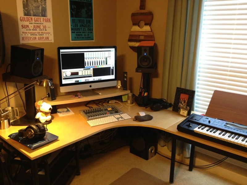

Also, here is a pic of the zoom at my desk setup. That's part of the ProAudioDVDs.com tutorial on my screen at the moment.

Now I’m into analog gear, about to set up a 16 track 1” tape and 20 channel console situation in my home studio. Seeing the pic of my “desk” in this thread cracked me up… and that I was worried that I’d be sleeping on the couch for spending too much $$… ha ha Oh man, if she is still putting up with me going analog, she’s a keeper for sure! Cheers and good luck!
