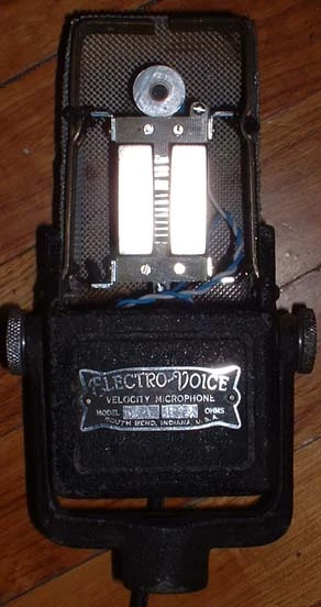

Please let me introduce my new creature. The world first ribbon--omni hybrid microphone. Well, probably not the first--remember WE-Altec 639A, but in this configuration--first. The omni part is based on WM61 Panasonic capsule and schematics found in ECM8000 thread. The ribbon part built around neodymium 10mmx10mmx36mm magnets. For now I put it in an old EV enclosure. Later, I will probably do something else.

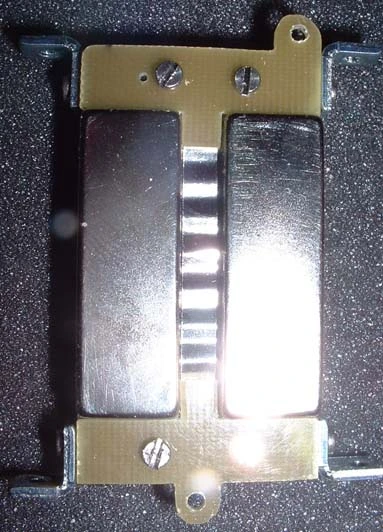

Here is a close up of the ribbon capsule. The ribbon itself is made out of 1.5 micron aluminum foil.

Marik, you'll get a much stronger field across the ribbon if you complete the magnetic circuit around the outside of the magnets with a U shaped piece of highly permeable metal.

It is too early to say something about sound, as I just finished it and have not tryed in real situation yet. From the first tests (on my voice) I can tell that the output of the ribbon section is very hot. The overall sound is very special. I was comparing it to different mics, and definitely this one has very unique qualities. If someone has a ribbon mic, try it with ECM8000--you will get same effect.

<Marik, you'll get a much stronger field across the ribbon if you complete the magnetic circuit around the outside of the magnets with a U shaped piece of highly permeable metal.>
I made this way for three reasons:
1) Simplicity of the construction
2) The magnets are pretty darn strong (I used N48 grade), and output is pretty hot, and won't get much higher with magnetic return circuit.
3) The thickness of this metal piece will increase lenght of signal path between front and rear and thus, will reduce high frequency cut off point.

It will get a lot stronger with a return path. Consider that you have two gaps in series, that in which the ribbon resides and the other going around between the other poles of the pieces.
That is like having two resistors in series. The return path, being longer is of much higher "resistance" than the gap so that the drop in the field strength will be predominantly due to that return path. Think of it as a resistive divider.
It need not be very thick at all to make a big difference. Actually, I'm rather surprised that you report it as hot. Those must be some intense magnets. :-)

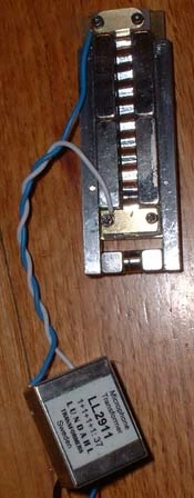

In theory it sounds right. The magnetic gauss is a directly proprtional to the mic sensitivity. Today I finished a new mic found in the picture below. I made it using neodymium magnets in return path between iron bars. And you want to know something? It did not make much noticable difference. These neodymium magnets are amazingly strong. How many times I pinched my fingers to blood... It is probably my speculation, but I suspect that there is a saturation point where the gauss is no longer so important. Remember Lowther speakers--neodymium magnets, air gap brought to the minimum, but still, sensitivity is around 103db--many vintage alnico magnet speakers have that.
Actually, now I think I should have built it without these iron bars for sake of HF response. BTW, the high sensitivity besides of strong magnets is due to very light ribbon.
Yeah, it is already my sixth ribbon mic I built so far.
Marik, did you compare the sensitivity of the assembly you show with and without the return path? You are right that theory predicts a big difference and I can't think of a reason why theory would fail in this case. I'd sure like to understand, though.
To say it isn't different is to say that you can increase the width of the gap without any reduction in field strength and I don't understand a mechanism that would allow for that behavior.

Yep, when once I used ceramics, it made a lot of difference, now--nope.
<To say it isn't different is to say that you can increase the width of the gap without any reduction in field strength and I don't understand a mechanism that would allow for that behavior.>
The gap width increase is square proportional to magnetic guass. That is probably the most I can say in this case. We need somebody here who understands in magnetism.
