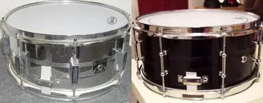

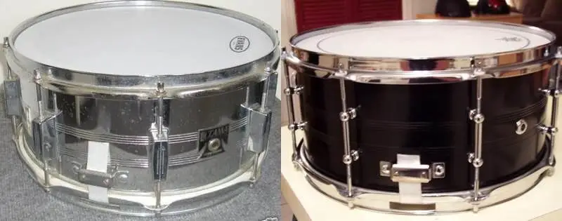

I went into the studio and they had a Vintage Metal Snare with the "Internal" Deadner and from then on, I WANTED ONE! I went on eBay and found a Vintage 6.5" X 14" Tama Metal Snare for $60 with the Internal Deadner. I wanted a Black Snare with Tube Lugs so I stripped the Hardware off, Steel-Wooled the shell to get the Rust off, and sent it off the get Powder Coated ($30!!). Bought the Tube Lugs and Vent Hole Cover for about $60. What I then found out was the lug holes in the snare were about a 1/8 cm to short. Soo I took a dremel and carfully shaved the hole out. Then put it all back together, and had a Custom Snare for about $160.

that looks mighty fine...
nice job, i would love to do something like that, if only i had the $ :(

Pretty nice, dude. Not my style, but hey--that's what customization is all about--getting what you want. Congrats on a finely produced project!

Nice looking retro on the steel shell!!!

Thanks for all the great feedback..... The only thing I DONT like about it is the little ribbs in the shell. I originaly wanted a Wood Snare w/ a Black Stain, but once I heard the Metal Shell at the studio, I fell in Love.
I acctully wanted to look into seeing if I could get a VERY THIN wood shell to just bearly fit and glue around the metal shell soo I could get the sound of a Metal Shell but the look of a Wood Stain....(I know theres snares called Hybrids but they are like 1/2 &1/2)
