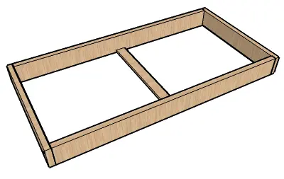

I just got the wood/nails/materials from Home Depot today, all I need to get now is some insulation and fabric which I'll try and get tomorrow. One thing I failed to notice is that my frame is 2x4, but when measuring the oustide.
That makes it 1' 10" x 3' 10" on the inside. Is this not such a big deal since I can just cut the insulation to fit it into the frame?
Also, I attached the sketchup file I made of the frame I'm building.
Someone tell me if you see anything that I should change before putting it together.

Put the cross brace under the entire frame, instead of inside. If you are going to keep it on the inside, add two more bars parallel to the middle one at the top and bottom.

Ok, thanks.
That will leave a little bump on the back when I put the fabric over it, but who cares. :p
Also I decided to use mineral wool instead of 703 because it's easier to find and it's cheaper. These aren't going to be bass traps, just an alternative to recording into my closet (for isolation/deadening).

My original plan was like the one in your first picture (the one on the left), so maybe I'll add a couple more boards on the top and bottom of the frame to hold the insulation in.
I'm not real concerned with weight. I thought they would be a lot heavier at first because I was going to use 2x4s :o
I may just get some burlap to cover the frame and then some flame retardant spray to spray on it.
Right now I'm trying to get as much absorption with as little reflection as possible. I'm trying to deaden an area of my room for recording.
Before, I was recording into my closet and using clothes to absorb the sound, and it worked well. But that's a pain in the ass so I thought setting up a few absorbers behind the mic would work the same, or possibly better.
