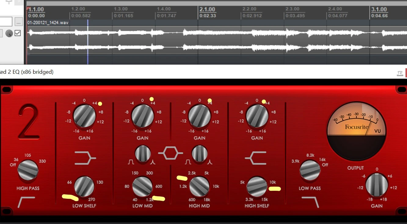

Starting to play with the drums. EZ drummer to me sounds bad. The ambient echo ruins the beats, not sure what is happening there. I turn off the room, and reverb, and sometimes OH. I wanted flat drums. They sound pumped up with power. So that means a bass enhancer of some sort at 40-50 htz. I rendered drum0 as it comes no EQ or anything. Normalized to -14Lufs.
DRum0 is stock as it comes. In the DAW no FX, but I did turn it down some.
Then Drum1 I added a bit of EQ , and a Big bottom enhancer. They should be compressed already. So I left that out.
I used Zorrofox's addvice form his beat mixing thread. I have no Pultec so I substituted the specs to the Focusrite RED EQ.
Is the Drum1 even any better? I spent some time messing with it. I heavily dislike the way the cymbals sound.

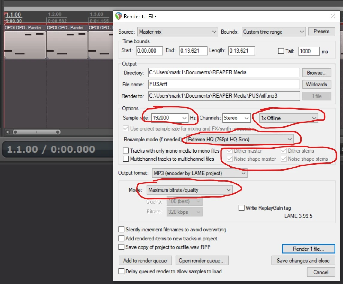

Here this is a higher bit quality. And the ambience is gone.
Would you agree? These hits don't have that hollow echo.
I changed these areas to maximum.

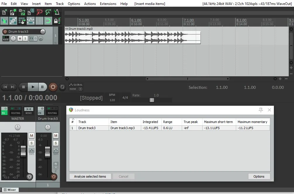

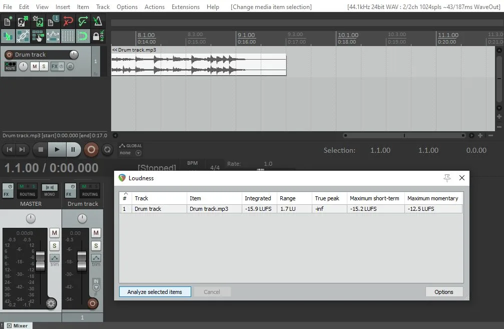

Here you go LBS,
The first is ALMOST there, -15.9 integrated, -15.2 short term, and -12.5 momentary LUFS, max peak reading is -0.5 dBFS. BTW, I had to compress and limit the crap out of the first one to get it up to -15LUFS and not go into clipping.
The second had a lot ride on the crash, and is a busier track. It has NO compression or limiting, and it hit -13.4 on the LUFS scale, and only -.7 on the peak dBFS.
WHY the difference? Read my post in your other thread about Renders. I explain the difference between LUFS and DBFS.
Attached are the MP3 and the analysis in Reaper.
