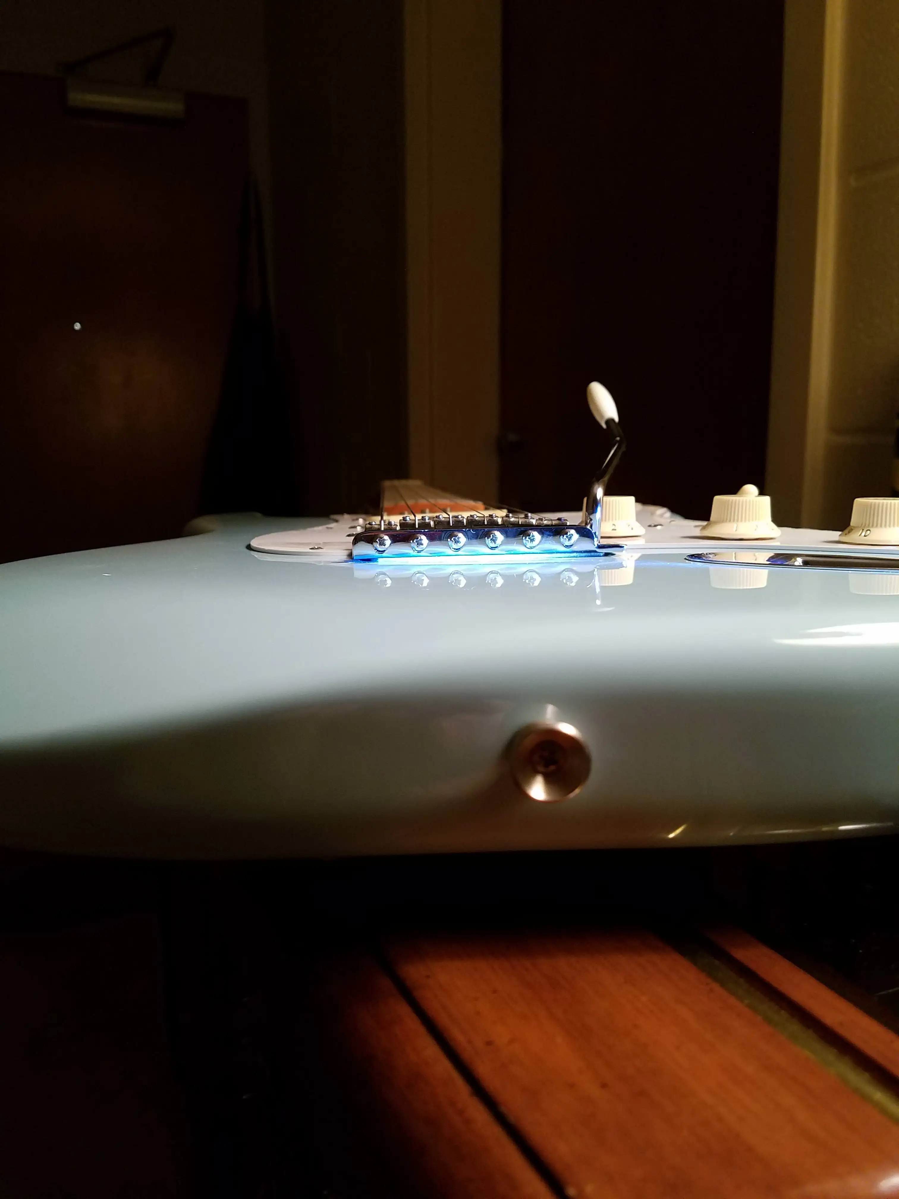

I can't measure mine, but it looks a tad lower than yours.
I don't know about your model (didn't read the whole thread)
But a loose vintage style screw in bar can be tightened up easily.
Get some of that teflon white plummers tape and wrap it atound the threads of the bar as needed.
It's specifically used in plumbing to seal up threads. Works like a charm.
:D
Yup, plumbers tape should do the job.
Isn't there meant to be a spring in there, though, before the trem arm goes in?
Could be a little close - depends on how you use it. I wouldn't mess with it if it's working for you though!
I was just jamming on it and it's working fine for me. Before I tightened it in, it hung down by the input jack and was hard to grab on the fly. Then when I let it go it dropped against the cord jack, making a loud clunk. Now it sits over the 5-way centered between the Vol & Tone.
