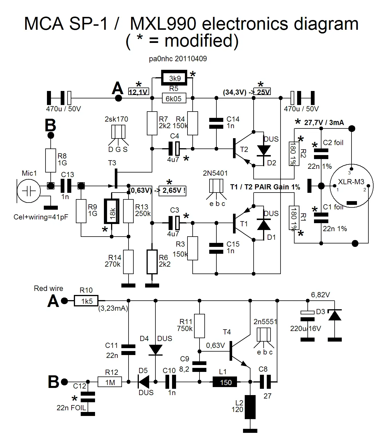

I've attached a few mod files I've gathered. I don't have a 990, but I've read they have the same circuit as the MCA SP-1, MXL 2006 and many others. Some of the mods require you to re-bias the FET. I have a 2006 and plan to swap capsule and try the "direct connect" mod, and then the FET mod when ever I get a 'scope.
Thanks for posting the info, but that's a little beyond me. Basically I know how to use a soldering iron, and that's the extent of my electronics skills. I would really need instructions that say "put this here, and here's where you get it". If I can't figure out how to even obtain the parts by myself, maybe I shouldn't be messing around with the circuit. I'm confident I could swap the capsule though. I'm PMing you about your shameless plug.
It's quite simple Potsy. reference that diagram above to the Gus' link that I sent you find C3 C4 and C13 and switch them out for the .22uf Metal Film Panasonic caps from Digikey on C3 and C4 then the .22uf Metal Film Panasonic caps from Digikey on C13.
Once you have the diagram and microphone all in front of you you'll catch on very quickly. ;)
+1. Also this link has photos: Nieuwe pagina 1 That is the schemo in the picture. PM'd you back, I'll post some photos in the classified.
