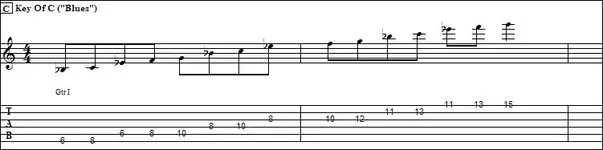

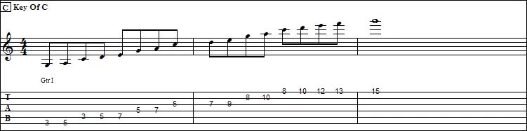

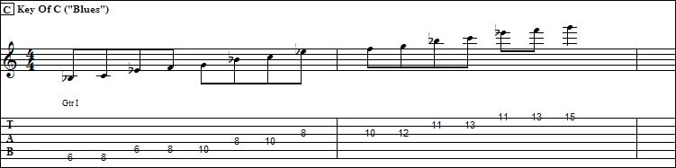

Until now, I've basically learned how to "solo" over stuff by learning other people's solos. After awhile I kind of picked up on a pattern that I could move along the neck depending on what key the song was in.
I've used basically this same pattern since then.
I also noticed I could shift everything up a couple frets and I'd get a "blues" sound.
I never really knew why, or what you would call these patterns. I'm guessing they're just scales? Maybe you can tell me...

The first pic looks like a C maj scale. The second one looks like C minor pent. A C blues scale would be the minor pent with a flatted 5th added to it (Gb). You can easily find two of them in that basic box pattern.
There are other variations but we'll just leave it at that for now.

From a different point of view, the first image is the C major scale (ionian) the second image is C Minor (aeolian). It's the same fingering because you're changing positions, but by moving a couple notes (changing intervals) in the first pattern, you could play that minor scale in the same position.
If you study the intervals of the major scale, which is what you're using in the first image there, and then learn what is different about the intervals in other modes (usually just 2 or 3 notes) you'll really be on to something! That's when you'll really start playing with intervals and note to note relationships instead of mindless fingering patterns.

But they are not just major and minor scales. They are pentatonic scales (5 notes).
Although the 2nd one is written strangely, starting on Bb. Major Pentatonic scales remove the 4th and the 7th.
C Major Pentatonic Scale: C-D-E-G-A-(C)
C Minor Pentatonic Scale: C-Eb-F-G-Bb-(C) Notice this is the same as an Eb Major Pentatonic Scale, just starting on C (Eb is the relative Major to C Minor)
C Minor Blues Scale would be (as Sirnothingness said) something like: C-Eb-F-(Gb)-G-Bb-(C)
C Ionian Scale is a C major Scale C-D-E-F-G-A-B-(C)
C Aeolian is like a C natural minor Scale C-D-Eb-F-G-Ab-Bb-(C)
But I think modes are way beyond this discussion.

Yep. Pentatonic major and pent minor. Good scales to know for improv. But written out in a confusing way (not identifying the tonic).
