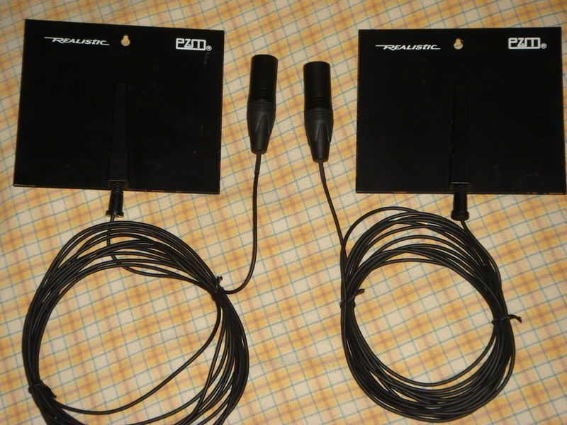

I just put these together today and it was really easy. I ordered two 15ft. extended lead msh-1s with capsules unhoused, and popped them into the hollowed out bodies of a couple realistic PZMs. The only tricky part was keeping the provided rubber isolation rings around the capsules when nesting them into the PZM shells.
It was well worth the 45 minutes it took to throw these together as they sound like a boundary mic on steroids now. If you have a couple sitting around, I would drop the 69 dollars to give your old PZM mic a new lease on life. Thank you mshilarious wherever you are!
