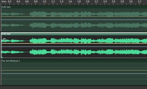

You can prove this to yourself if you want to.
Take any random audio file you have. Save a copy as uncompressed wave. Save a second copy as FLAC--note that it IS a much smaller file size.
Re-open both versions in your DAW and line them up in a multitrack session. Invert the polarity of one of them--doesn't matter which then mix/render them together. The result will be a flat line of silence indicating perfect polarity cancellation which in turn proves both files were identical despite one being compressed in FLAC.
If you want a laugh, try the same thing with MP3.

Even better -- Export as flac, load again and export as wav, load again and export as flac (wash, rinse, repeat a few times if you like) and THEN invert it to the original.
Unless something went wrong, they'll still cancel out.
Here you go.
Top clip is the wave version. The middle clip is the FLAC version.
The bottom one is what I get when I mix the two together after inverting the polarity on the wave version. (It works equally well inverting either of them).
As for multiple wash and rinse cycles, I'm bored today but not THAT bored--however I'm sure it'll work.

Nice demo Bobsy. I was a FLAC sceptic for ages (well, until I bothered to do some research) but am a convert.
