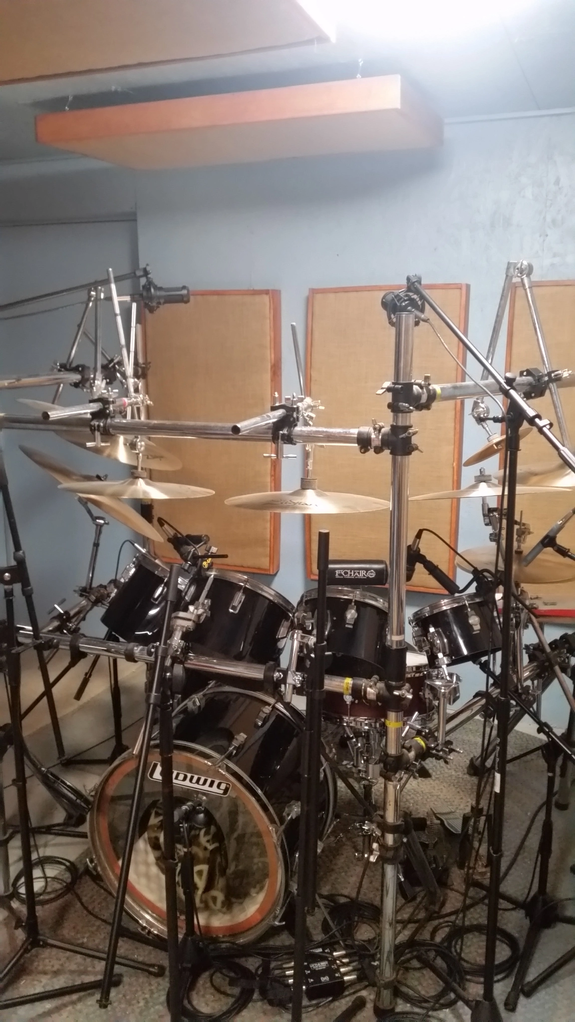

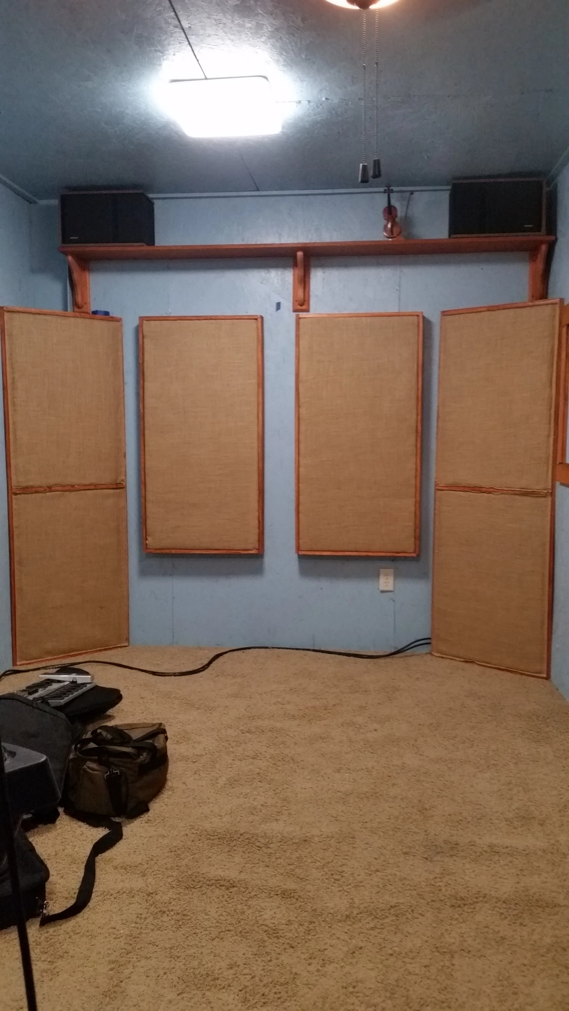

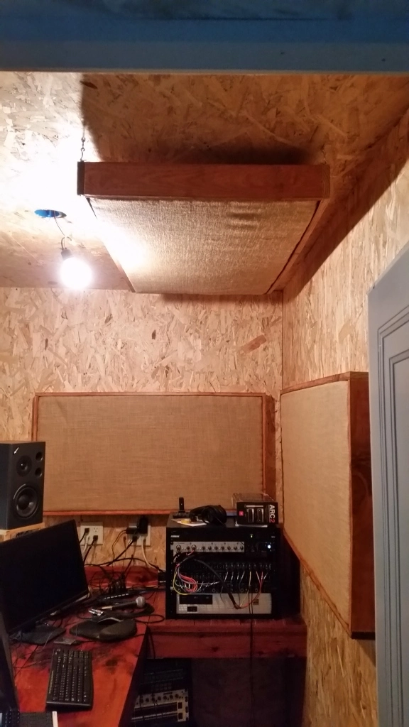

you can build your own panels really cheap, I have about 30 bucks per panel in mine.:D

You mention 'sponge' regarding acoustic treatment. Don't buy acoustic foam if you haven't already. Invest in rockwool trapping as Atkron mentioned.
