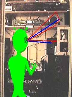

The walk-in closet in 4'4"x4'4"x8'high. The walls are sheetrock, the ceiling is blown acoustic.
SEE ALSO ATTACHED PIC
The monitors are on home made supports (from the floor) that hold two shelves with the VSR-880, CD Burner, Tape deck etc. The Event PS5's are on their side (tweeters out) and are actually supporting the weight of the second shelf. There's a picture attached (sorry it's messy), perhaps that will help some. It's shot thru the door into the "closet control." I'm considering "coming out of the closet" and moving into another bed room. It's just real easy to work out of the closet since most of the recoding I do is by my self.

First the closet :)
Whereas you can design a larger space to be acoustically correct for its purpose, you have no such luxury with a very small place. Therefore, there is only one thing you can do, which is to make it as "dead" as possible. In other words - get foam and start glueing.
The monitors. The reason I recommended the LSr's is one very simple one, they are many times better than any comparable product in their pricerange. You would find none of the other monitors you mentioned in high end studios, where as you will find more and more 25's in exactly such places, as well as in many post and surround facilities. Also, the different set-up configurations (switches in the rear) have some settings which make them ideal for a small space.

Another big problem I see you have are reflecting surfaces and diffracting edges very close to your monitors.
These secondary wave fronts (see pic) will interfere with the direct signal and cause response peaks and dips. The closer things like this are to your monitors, the higher the amplitude of the reflections and diffractions, and greater the response anomalies.
Try too pull your monitors out in front of the gear and shelving.

Bare foot, How'd you know what I look like? Just kidding, great recommendation. I put the monitors as far a way as possible thinking, it would allow the low end to develop more. I'll move the monitors closer and see what happens, also, I'll put foam ect on walls behind and to the side of me. Would carpet work, or is studio foam better? I have carpet hanging in the room where I track and it seems to help with reflections.
