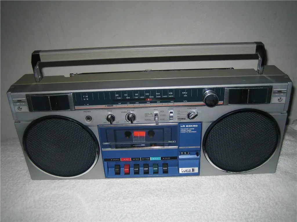

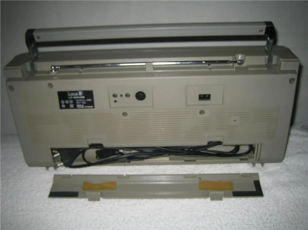

I´m sorry, I´ve read the manual with block diagram online, but now I can´t seem to find it! But here is two pictures of the model from the auction. they´re not the best, luma.webpluma2.webp
Gonna venture guess here, but...
Looks like maybe (2) ext. mic inputs on 1/8" and ext. speaker outs on DIN connector.
