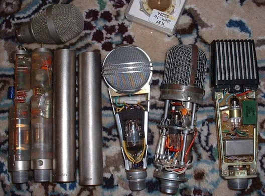

Have a look at the attachement--that's how Russians used to build mics ones. On the very left is a CKBK--pay attention--completely silicon sealed--reduces microphonics and keeps moisture away from the board.

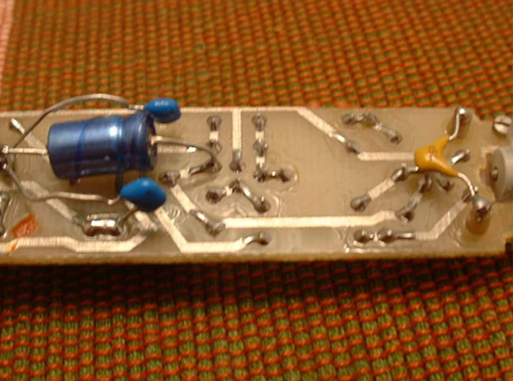

Somebody just brought to mod:
