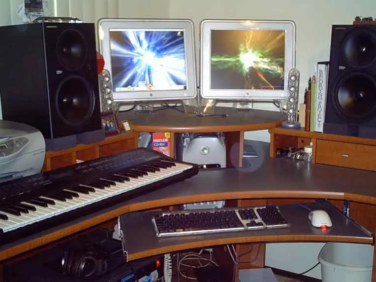

i work with mine in a corner and im pretty close to mine, so i have my accoustic spaceing set to "B". I have no room treatment yet and i have a pretty live bedroom, i made a mix reciently that was a little strong on the low end. I set the HR 824's to the "A" position and that made things much more accurate. Use a RTA when you mix as well............so you can see whats going on too.
close
as you can see here...........im pretty close in lol

zallen 25, i'm going to need to get some foam like you have so my speakers can sound better. i read that i can even get those neoprene mouse pads to do the trick. good post. i'm in a pretty live room with mine also.
lol............the mouse pad is a good idea. I just got a bag of the auralex Mopad's. They are only like 30 bucks or so and they have pre-cut wedges so you can aim your monitors to where your ears are. It's always good to isolate your monitors from hard surfaces to eliminate the buzzing effects of the desk and other junk on it.
Thanks for listening guys. I peeped zallen's setup and I see that yours monitors are about the same distance from your ears, as mine are to my ears. Only difference is that my monitors are pointed in front of me and not on the sides like yours. Maybe I should rearrange my room so that I can have mine kind of on the sides also. I see that all of us have live rooms and need some sort of material to hear our low ends better. If you have any more info on the mouse pad idea, let me know and I'll pick some up. (If it actually works, lol). Thanks again guys.
