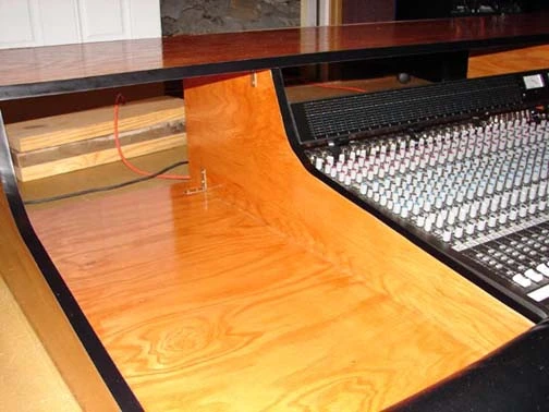

Rick is correct. That's why I centered the legs on mine and cantilevered the load to the left and right of the legs.

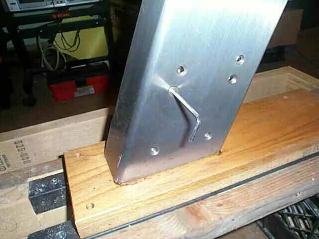

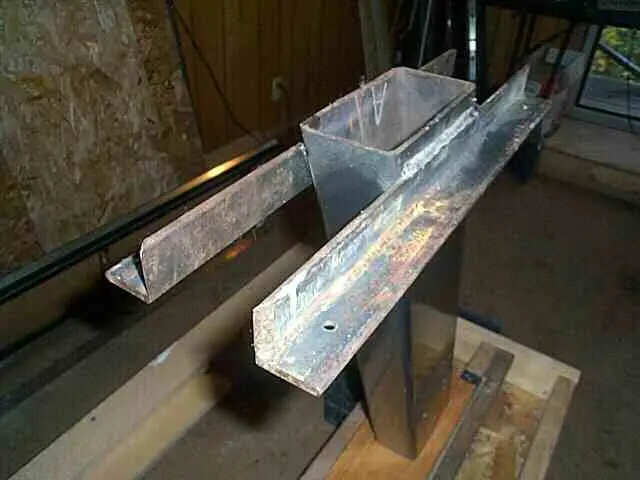

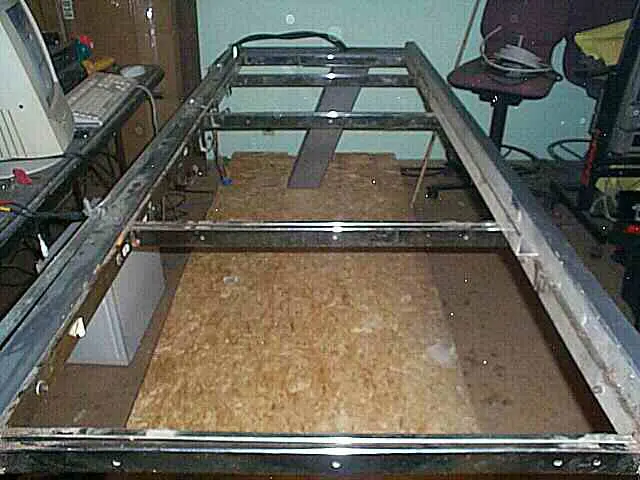

Hi Seeker. Here is a suggestion. Instead of the 3/4" plywood for a deck, go get yourself a 24" HOLLOW CORE door blank, with an oak veneer for a skin. These are really strong for their thickness, because the leafs are glued to a HONEYCOMB on the interior. If you need more support, screw a 1 1/2" x 1 1/2" metal angle to one or both long edges. This was actually the basis for my metal framework. After 3 prototypes, it dawned on me. The metal edges are actually part of a frame. :) These might give you some ideas. :)

The only thing I can't do is weld. :( Rick, that looks bullit proof.

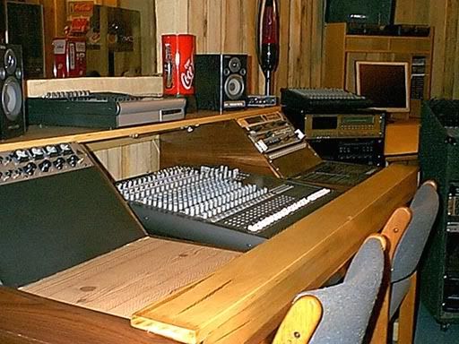

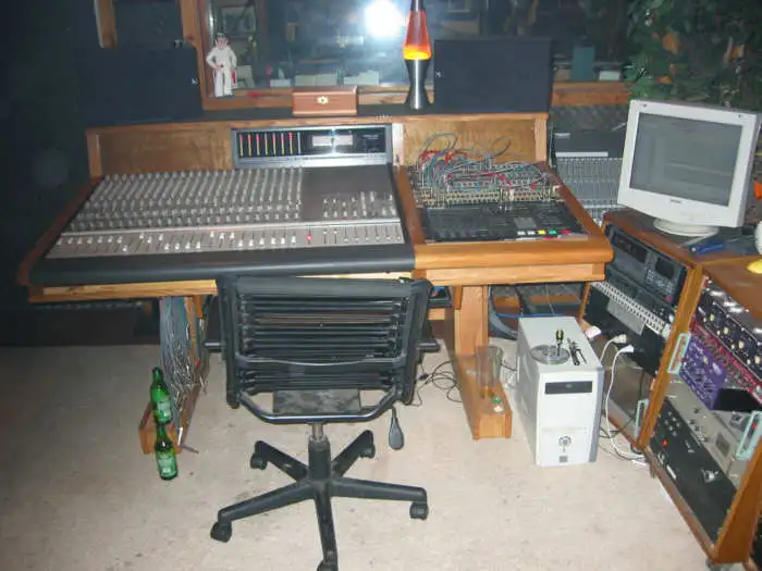

I built my Mackie console Sesk
a>
I built mine out of solid oak and maple. The measurement I came up with looking at rack mount demisnsions and the contractors specs of a mackie 8 bus
Nice desk Randy! I dig the multi-tone wood colors/types. Mine is a little different but same concept; will not have near as much rack space as yours, but oh well. I got the edge banding in the mail yesterday, have the banding cutter and legs on order. Leaving now to Home Depot for stain, sporting store for foam, craft store for vinyl.

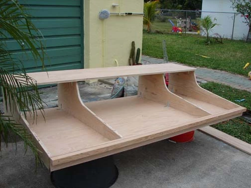

Photos from last weekend before the finish was applied and before legs. I'm working on braces/lateral supports between the legs and they are drying as I type. I'll post the semi-finished product (without rack rails and gear) soon.

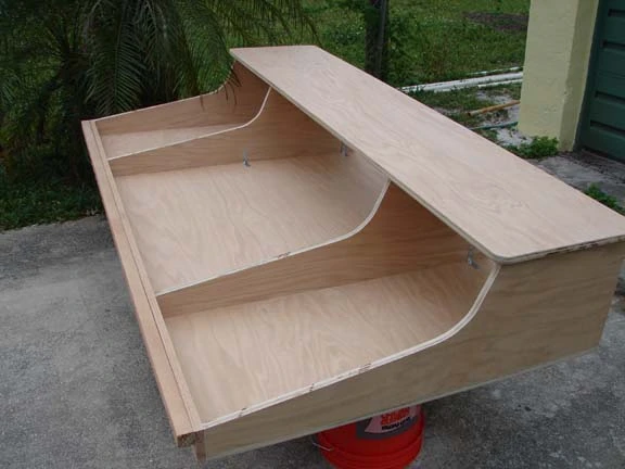

Same shit, different angle

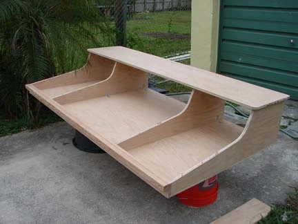

And one more for good measure. I'm not extremely happy with the padded armrest so I may re-staple it. Not seen in these photos of course, but just in case I post some in the next day or so with it.

Legs are done as of today Fitz. I took into consideration what you said about sag and think I've made a solution. I ran (2) 1x12 pine panels (vertical of course) between the legs and bolted to the leg frames at either side, crossbraced at two points along the way. That way the span of the board is supported by a joist system. Seems rock solid, but my father-in-law just left back home for Indiana this morning and I'm afraid the only one available to help me lift the beast of a deck onto the frame is my pregnant wife :(

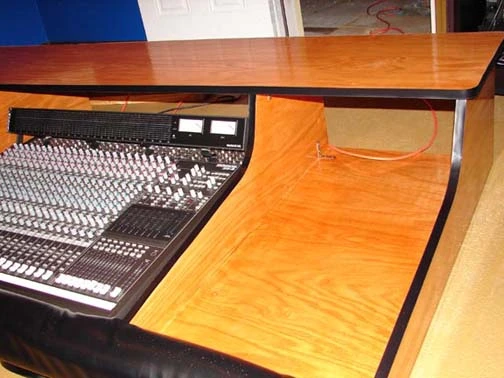

Anyway, here are some photos of the top assembly after applying the black edge banding and after the finish was applied. Btw, alexfranke, thanks for the lead on the banding. The pre-glued stuff works great! The photos below show it as it is now, before I trim the edging, and I'm still going to fix the armrest. Still have a few details to take care of, but almost there. :)

Another pic
