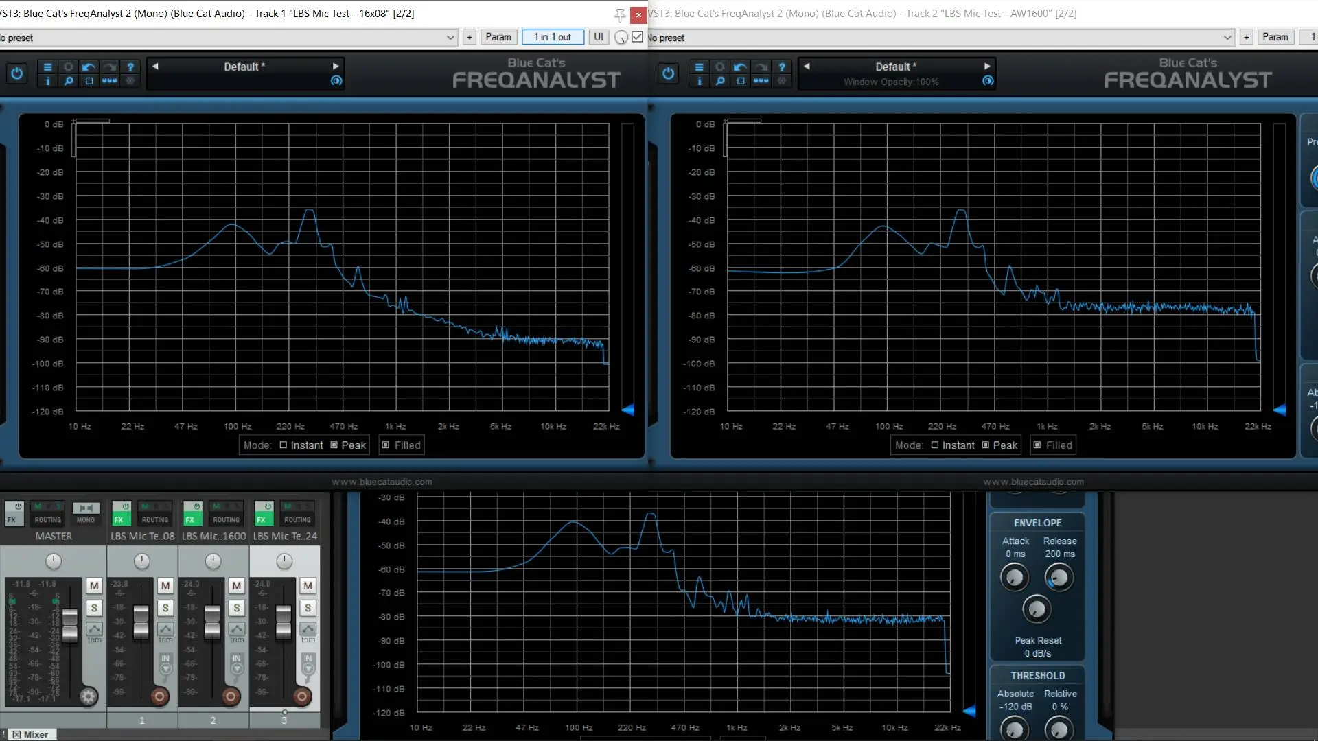

I need to pull out my old Yamaha MX12/4 mixer and connect it to the line inputs of my Tascam interface, pull out a couple of matched pairs of mics and see what it sounds like. I recently did a comparison of my Tascam interface vs my Yamaha AW1600 and my Zoom R24 using 3 Senn 835s. The sound was similar, but the Yamaha was by far the noisiest of the three recording at 24bit and 44.1K.
I ran the three files through FreqAnalyst and this is what came out. You can easily see the noise level (it was an acoustic guitar recording).
