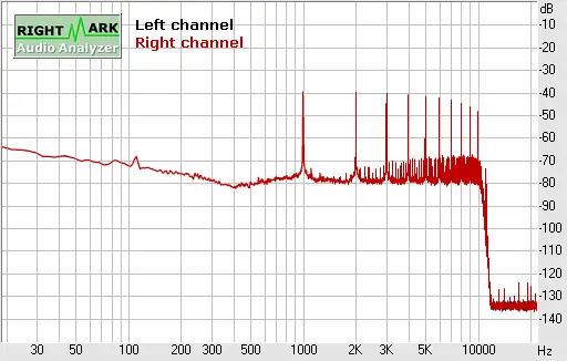

If it has worked the attachment should show the spectrum of the noise with the characteristic spikes. You cannot eliminate these spikes but you can push them down to -75dBFS or so where they won't be heard above ambient noise.
Go into the sound menu and find "usb microphone" or similar. Find "Levels" then crank it down from 100% to around 5% or even less.
Agreed the problem is caused by cheap ass'ed converters and drivers but also because Win 7(w8?) defaults generic usb audio device to mic gains. The final solution is of course a proper AI with decent drivers and 24 bit operation.

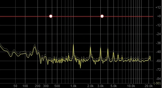

That's the EQ curve I get. Amped it by +36dB so that you could see what I'm getting. This seems to be much lower than what I was getting when I first posted this thread, but it's still audible and I have nothing connected to the mixer (no mics, all faders at -∞, EQ and FX all off). I don't hear this noise on headphones.
I know that the noise isn't a constant set of frequencies, but do you think I could take a sample and invert it out of the recording to get most of it out?

The frequency graph shows the spikes at 1K, 2K, 3K and up, you could try inverting the recorded 'noise' and adding it to the track and see if it works. It's coming from the USB part of the mixer, so it doesn't matter if there is no input signal.
