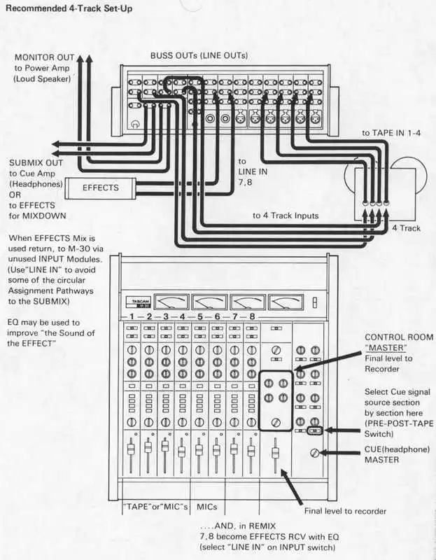

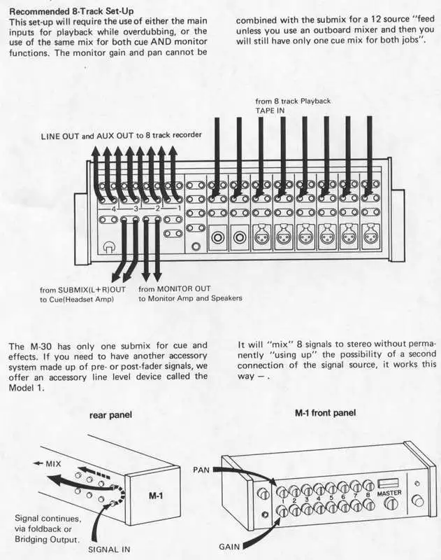

There were 2 versions of the 58. The first one, 58, with RCA ins / outs (-10db) and another one, the 58-OB, with both RCA (-10db) and XLR (+4) ins / outs. If you have the latter one then you don't need to use the XLR's. Those are great if you're using long cable runs but if you keep it short, RCA's are fine. The point is, you can get a great mixer at -10db, such as the TASCAM M30, which is geared for true multitracking, would be less expensive and sound better imho. The M30 is a 4 bus mixer but you can set it up for 8 track recording. On the other hand, if you don't need to record 8 inputs at once then that's a moot point. Actually any of the TASCAM mixers would work well.
This is the typical 4 track setup:

thanks for the reply cjacek. I have the 58-OB & I would like to have the ability to record up to 8 tracks at once.
