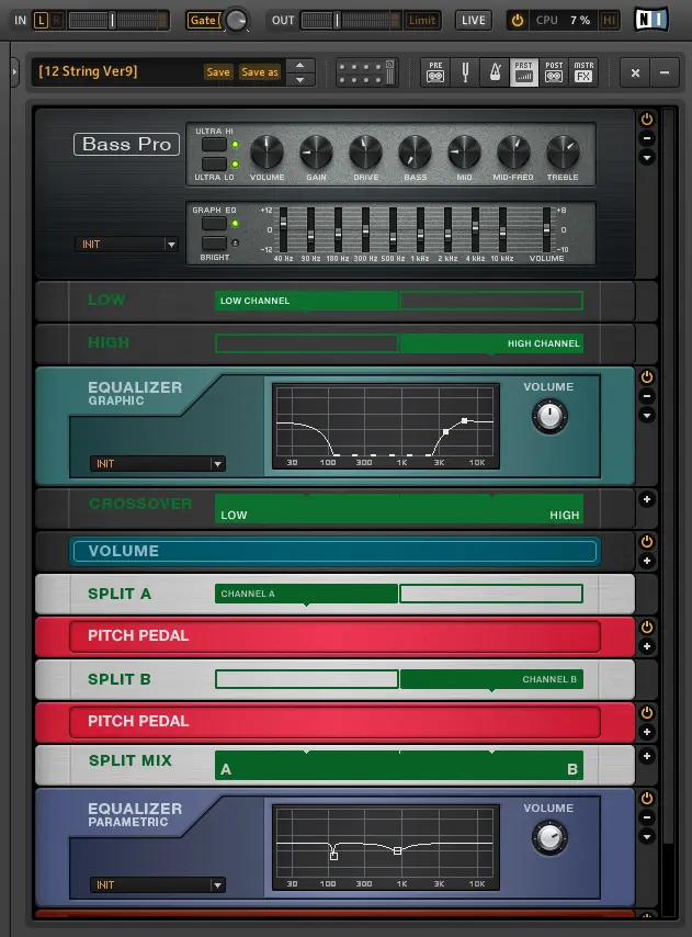

I recorded it again and it doesn't have the clicks anymore but I still get that "shh" sound all over the track with some presets (especially the one I want to use). What should I do?
OK, you will have to go into a little more detail than that. What is the effect you are using? This may be where you might have to do a little research to understand the effect, what it does and what the settings mean.
But we can get you started, what is the plugin that is making the noise (sounds like a phase pedal or something like that.
Here is a picture of the preset. I'm not sure what is making the noise, I already tried turning off every effect one by one but the noise doesn't stop
