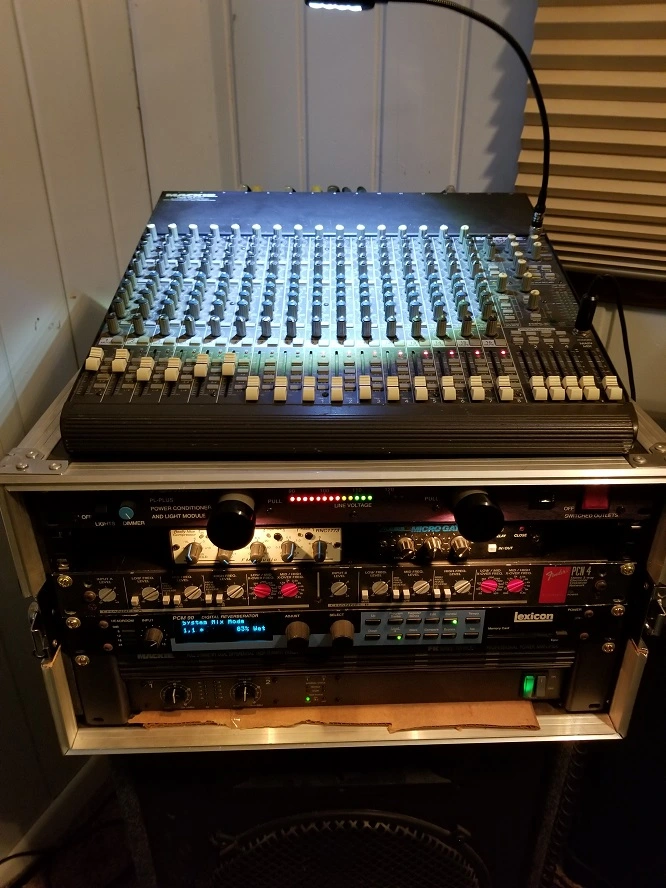

Yeah through a mixer+PA live it sounds different. I have a Mackie 1604, but I would not think to use it with a DAW..
My Pa is set with the mixer to monitor the 8 track 1/4" on channels 9-16. So I leave em muted. Constantly I compare the tape to the digital DAW. Then complain about it.
Its the mixer then? The multi channel bus?
Nice setup! Yeah I have an interface that outputs multiple channels to the mixer, then I just record the 2 track out of the mixer. I’m actually not picky about digital vs analog, it’s just the features I want are only on the analog mixers I’ve found. Do you tend to alternate between tape and daw? Or how do you use your outboard gear?
