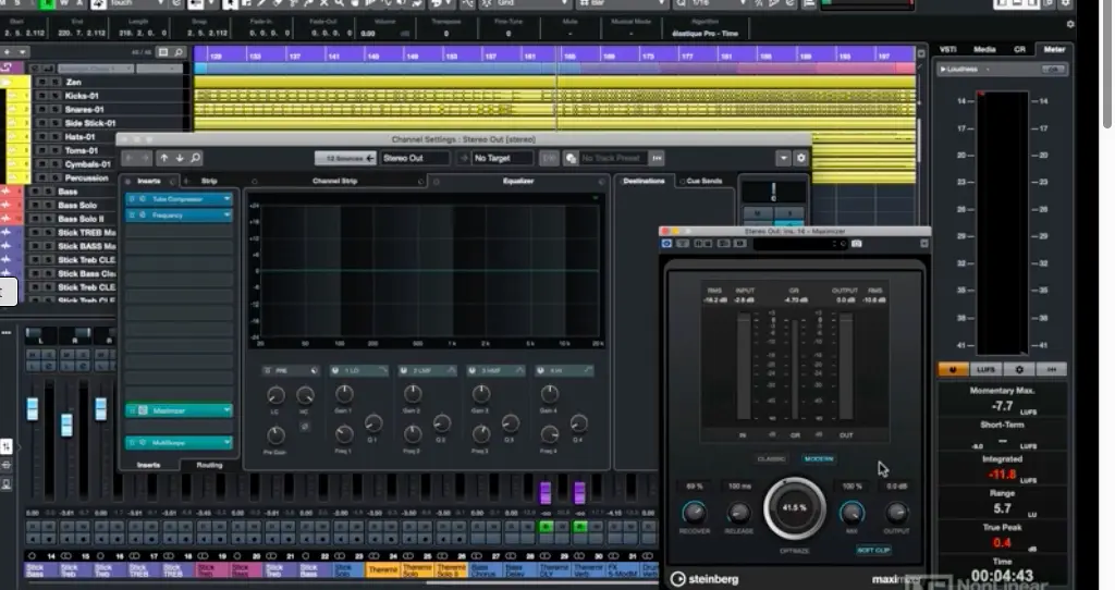

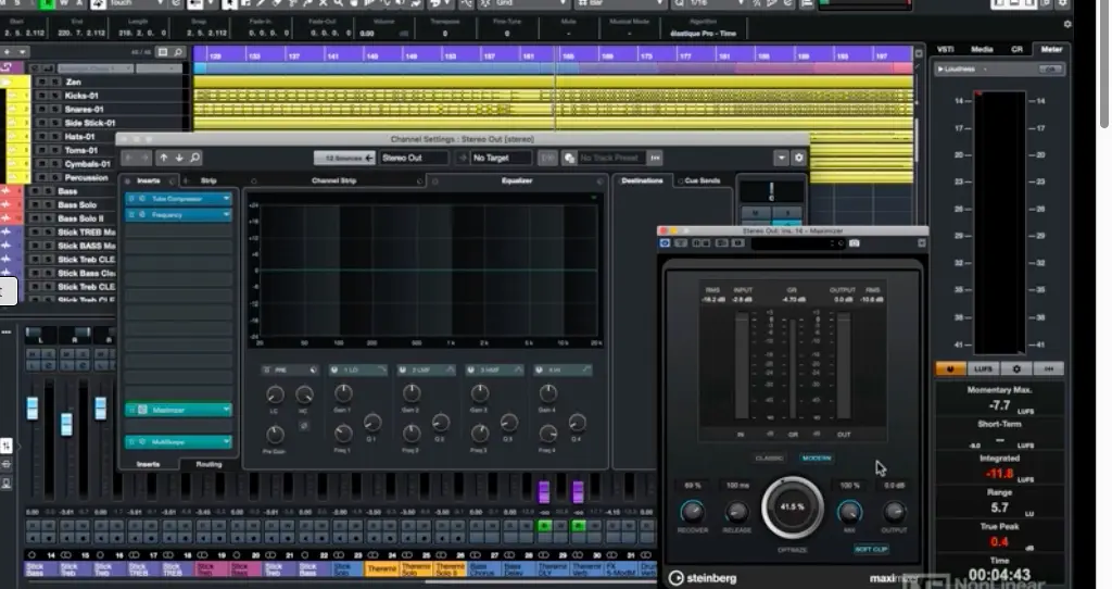

its getting better...I need more time for technique..thanks for the info/replies.. btw look at this screenshot of Cubase...is that meter on the right with the LUFS available in Artist??? if so what is it called..?thanks
