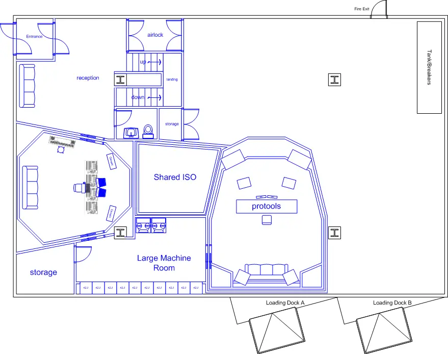

Drawing #37 (I think)
This just gets worse and worse :)
Friggen columns Grrrrrrrrrr!

the iso-room is so isolated, no one will ever get in or out!!!
Its that isolated for a reason. Musicians I don't like go in there until.... heh-heh.
its a work in progress :)
The eversoisoroom?
A question on the layout - the large space where the columns are?
What is that going to be?
The eversoisoroom?
It has doors now :) I have to figure out how I got three walls between the main console room and the large iso room, thats an interesting quirk I did.
A question on the layout - the large space where the columns are? What is that going to be?
Thats undesigned... but... I was thinking of building a pair of walls diagonol from the console room corner to the pole, then to the fire door area, making two larger rooms. Or a larger room and a smaller room all the way to the right as a drum room. These are just random thoughts.
Ideally, I'd have a "midi composing room" all the way to the right against the garage bays since soundproofing is less critical for playing with Midi, run the cabling behind the main console room to the machine room, and north of that have a large iso room for drumkits and/or a piano, and a big live room at the top, reaching the main console room.
The smaller console room on the left is what i would call a mastering, or mixing room, so that recording can be done in the main area, while mixing/mastering of another project be done in the smaller room.
Just ideas... revision 37 :)
As you can see I'm not very good at this.
I wouldn't say you're not very good at it, considering its not your job, its showing promise!;)
I just wondered where your main tracking area was going to be, i.e. if the big space was going to be part of the studio.
Thank you, that was very kind :)
Yeah, the big space on the top and right that the two columns, and the fuel tank are in.... the majority of that is going to be a live area assuming I keep this design heh-heh.
The problem I keep running across is that I'm trying to carve up the space too much. When I bought the building, I was thinking "Damn, 3375 sq feet is HUGE!"
After the first 15 or so drawings I realized its not quite that big. Of course the columns keep getting in the way, which is annoying.
Then I got smart, since the leftmost 1/4 of the building (from those two columns left) has a 12' ceiling with a slab over it unlike the rest of the building, I'll give up a little 1st floor real estate and put stairs in, thus taking out the offices and cubes and conference room, moving that junk to the second floor.
Then I thought... "Damn, 3375 sq feet of usable space is HUGE!".
Yet its still not! Trying to design around the columns gave me the most trouble for the longest time too... I wasted a lot of time on that. However, after a lot of research on my architect's time both of those columns in the big live area on the right can in fact be removed, if I go for approximately 45K worth of steel work to use the concrete walls for support of a cross beam (or two) and support the roof off that. I'm still trying to design around the beams because 45K of gear is a lot of gear. Or, 45K of soundproofing, plumbing, walls, sheet rock, hardwood, etc. Thats a good chunk of cash to part with just to remove two 12" square obsticals. But I may have to. THis is the closet design that I've done where the upward beams aren't totally in the way.
Trust me, I'm aware of the oversized deadspace on the bottom left. The huge storage room is grossly oversized and the machine room while cute with all those racks, is also grossly oversized. I'm thinking of rotating the big console room slightly and moving it left, so the front still faces the majority of the live area, but shortening up the machine room, and using the bottom storage (leftmost room) as the vocal/iso booth for the left, smaller console room. This way the live area can be much larger, and I can put smaller iso's off the perimeter walls.
I'm not sure if my problem is my brain or my ability to get my visualizations into visio fast enough before I dislike the design :)

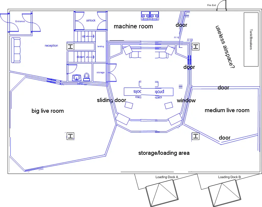

I haven't read your criteria for your warehouse/poles/studio area. However, no offense to you, your utilisation of space was killing me. You had a lot of pokey rooms. Lets get some SPACE! Cover up the ple in the big live room with something that makes it look cool, like bricks, or wood, its not going to ruin the sound i don't think. but give people space to LIVE! make your control room bigger, people while caged up like space. as for acoustics, i have no idea what will happen.
Oh yea, there is no "mastering room" or "midi room". but really, how many things do you plan on doing at once? just my idea.

Oh yea, there is no "mastering room" or "midi room". but really, how many things do you plan on doing at once? just my idea. [/B]

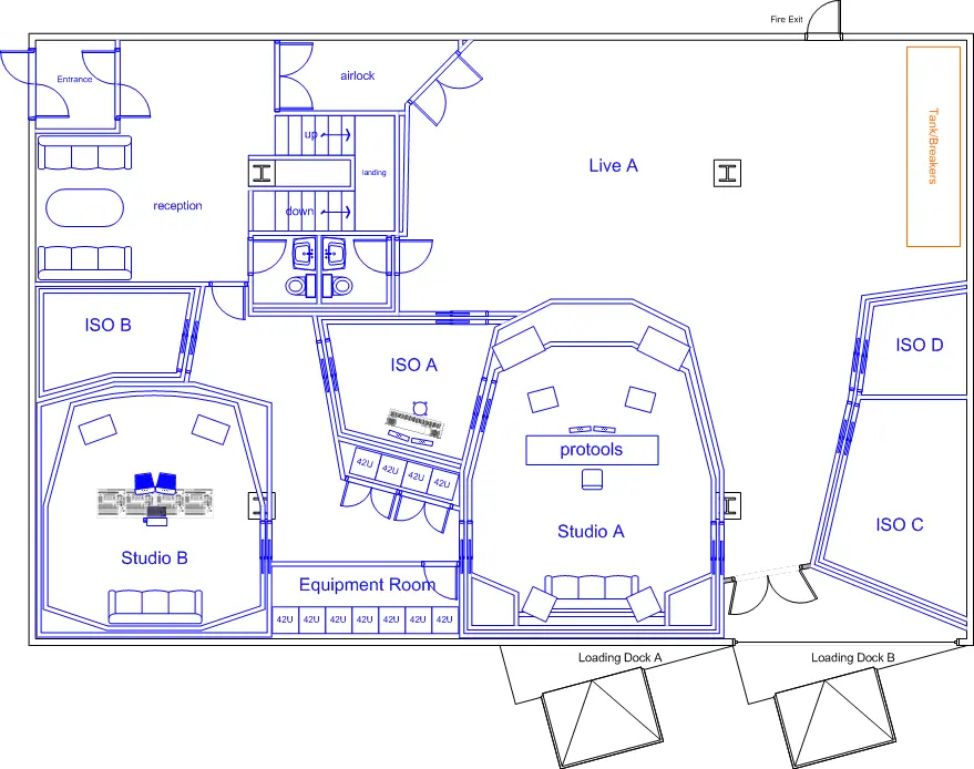

Design #57 - Much better!
Four hours of conference calls has proven useful :)
Anyway, new design.
Notes:
1. Offices/cubes/conference room still upstairs.
2. I have not included soundproofing nor bass traps, just
the overall shape/shell of the rooms.
3. Access from room to room seems reasonable.
4. Added a second bathroom for in-studio client use. I know its
off the live room, but there really isn't a better way of putting
it anywhere else. I don't expect it to be used when the
recording light is on.
5. I deleted the tank (its now red) since its been confirmed its
currently a 1000 gallon boat anchor.
6. ISO A - has a midi controller in there, and on the back wall
there are racks for endless midi gear expansion.
7. ISO B - while not rectangular, its not idea and I will be
tweaking the top wall a little to change the angles a bit.
8. I decided after all that one of the loading docks should be
accessable, so I've walled it off and put a pair of double doors.
I can double this wall if necessary... I might wait and see. The
Metal garage door doesn't seem to rattle or flex in the wind
so maybe that area would be a decent airlock. I can decide
that during construction. Adding another wall and two doors
is not a big deal in the scope of things.
9. I have the larger console room more exposed to the live room,
something that allows better communication between artists
and engineers. I haven't drawn the windows into either of the
control rooms, thats still a "to do".
10.And to comply with local law, the emergency fire door is
exposed and available for panic exists. It makes the most
sense to have the live room against this door thats where in
theory, the majority of the people would be at any given
moment.
11.The Equipment room is no longer humungous and overbearing.
This makes for more usable space yet gross overkill in the
amount of "U" available for recording gear and other devices
that can be remotely controlled.
12.Studio B will have outboards and compressing gear built into
the console table, equalling 15U total.
13. Studio A (large) will have 32 U (16 per side) built above the
bass trips next to the sofa. Not exactly the most ideal
location but its acceptable, as most of the outboards we'll
be using will be midi controlled.
Whew!
I think I covered every room I wanted except for a kitchen. There is enough space upstairs on the 2nd floor to put a small kitchenette for client/employee convienence, with a small table or two. Just something to be friendly.
