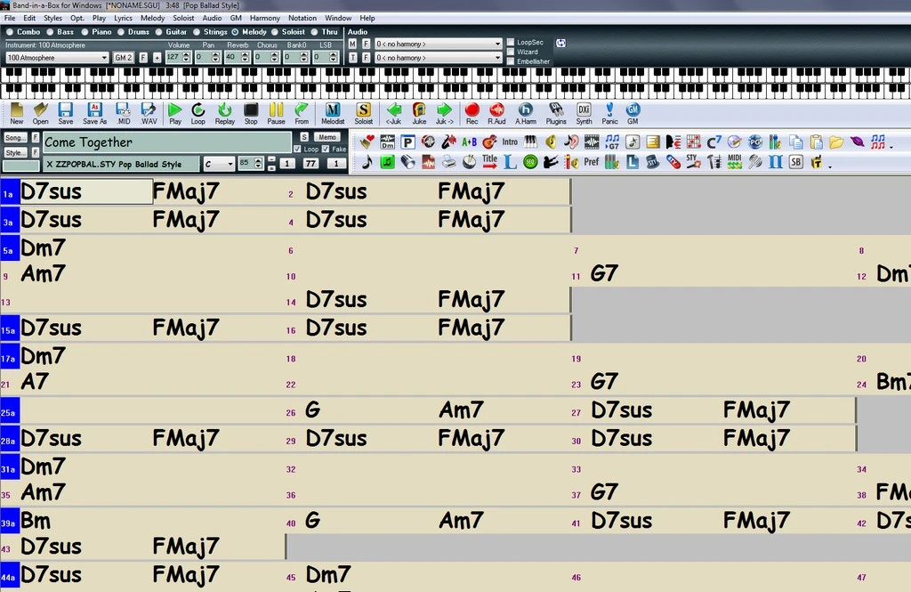

Here's a screen shot of Band in a Box with the MIDI file Come Together (Beatles) loaded up (picked at random and other files may be sequenced better than this one). Also a short clip of the file attached as an mp3 file playing the default BIAB instruments.
