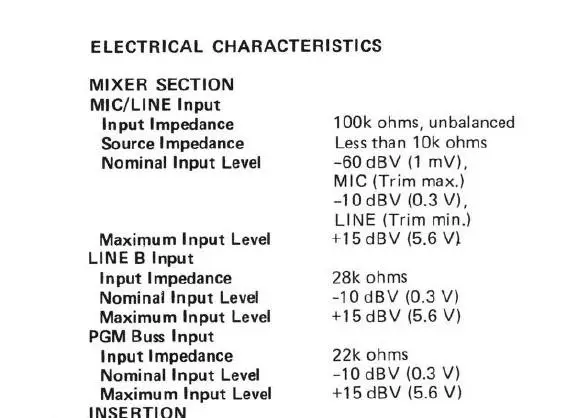

Still have an old 246 that I haven't used for years and the 244 is likely similar. The 1/4" input jacks are 'unbalanced' and an input impedance of 100kohm (not Hi-z like an electric guitar might want, unless you like a dull guitar sound). You can use SM57/58's, but would need and impedance matching transformer like https://www.sweetwater.com/store/detail/LittleIMP to match impedance and convert balanced to unbalanced. Way back when I was using the 246 I wasn't educated about condenser mics and phantom power, but used condenser mics that had a battery such as an AKG C1000s and an AT ATM-31 with the impedance matching transformer. Probably would use a cheap preamp with phantom power today if I was going to haul it out of the closet and use a real condenser mic. Cheap preamp would work for an SM57/58 or similar dynamic as well.

Could be different, although it does state 10kohms on the 'source impedance' which I don't know if I've seen in any other preamp specs. Never have tried without the transformer and it may very well work OK. Specs from the 246 owners manual....

In my 246 days I used 57/58s with the balancing transformer and an AKG 414 with a dedicated AKG phantom power box. But anytime a mic went into the unit went through the adapter.
I can't imagine the 244 being much different. But, I could be wrong.
Maybe the 246 marked a turning point in tascam's pre-amp design? I mentioned on thread in the digital recording forum how disappointed I am with the inputs of the Tascam digital recorders with regard to connecting dynamic microphones. It came as quite a shock after the great results plugging the Shure and other mics directly into the 244.
