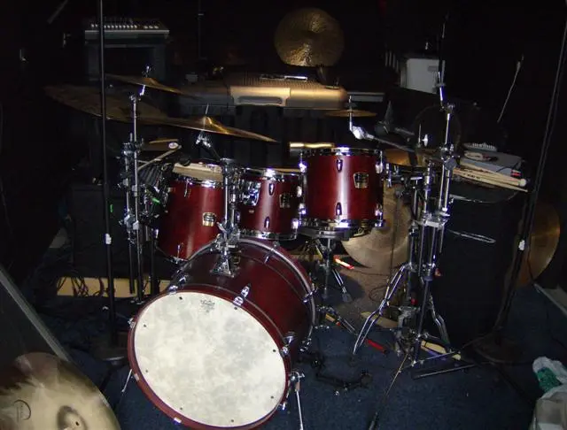

OhSh1rt said:
Why not just slip a barbell weight down it, the weight would be evenly distributed and should give the same effects without the weights slidding off
I guess lots of people come up with the same ideas independently.
I'm using a ten pound weight on each of my booms...exactly as you're describing.
Remove the boom, slip 'em over the shaft of the lower section, and let 'em slide down to the base of the tripod. It lowers the center of gravity significantly. Even with my On-Stage pieces of crap, the booms fully extended, I never have to worry about tip over.
Kinda hard to see, but if you look closely, the booms are to the lower left and right of the frame:
