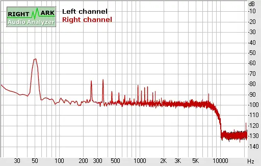

OP. See my attachment of your test sample. Weird that chop off at 10kHz and you have a serious 50Hz hum problem.
But then I don't know how an MP3 encoder forks a noise signal? I think "test" signals should be attached as .wavs, I only need a 10 second clip for Right mark Anny.

I just had a look at the test file and see much the same thing as ecc83.
However, the sample doesn't tell us much--the whole file is 283 kb for a 36 second test which means a very low bit rate MP3 coding was used. That would explain the steep roll off at 10kHz and probably some of the noise. (FYI, the noise floor sits at about -48dB). However, some of it also sounds like the typical noise you get from cheap internal sound cards in the noisy environment of a computer.
So...it's not possible to be very specific but there's every reason to believe that your issue is to do with plugging straight into the cheapie sound card in the computer. I certainly wouldn't be buying a hum bucker coil--there's every reason to expect that a proper interface could cure everything at one fell swoop. However, on top of that, work exclusively in wave and never use such a low bit rate for your MP3 copies.
