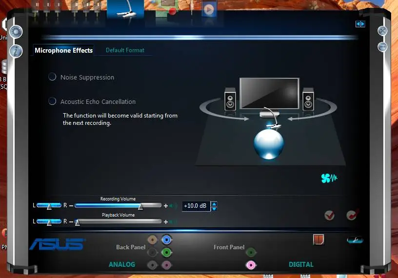

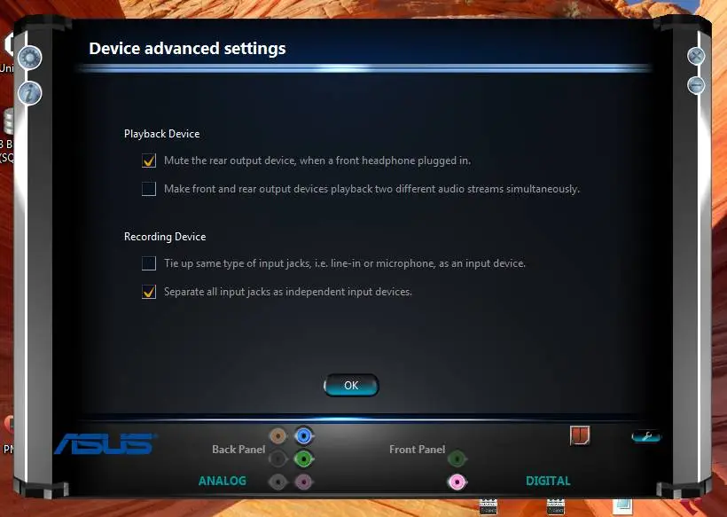

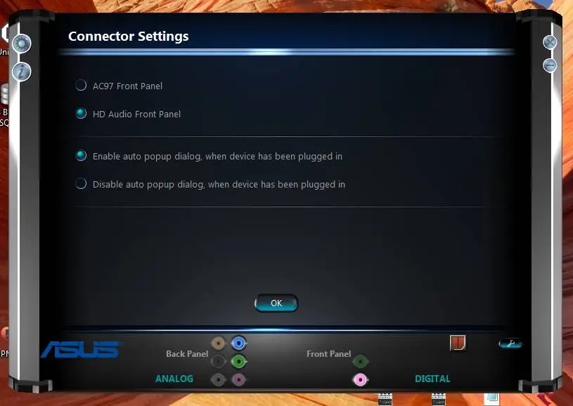

Below are screenshots for my ASUS soundcard software....
