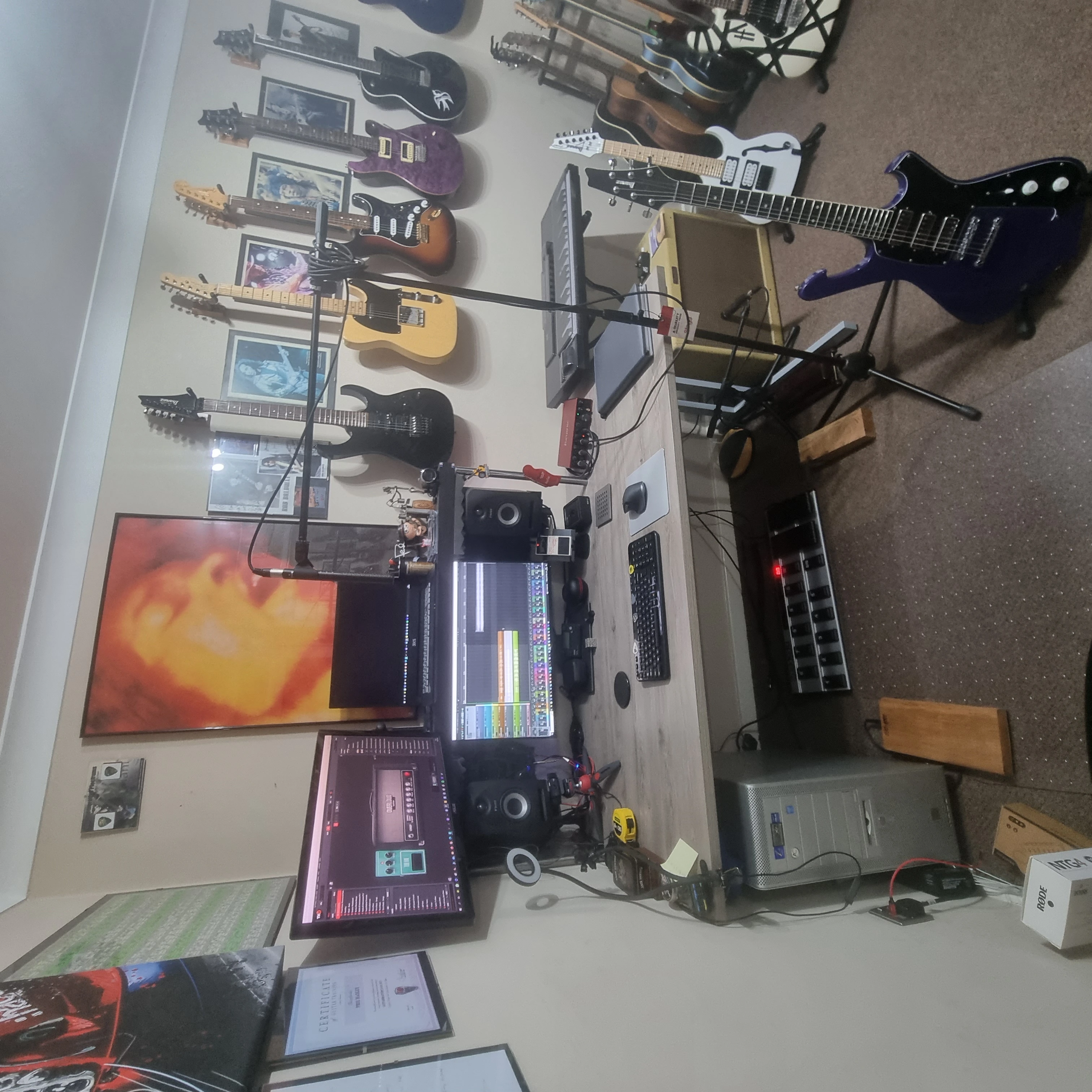

My setup is below.

Two things I hear... first your vocal isn't as "close" sounding as either of the two videos. Paul Gilbert sounds extremely clear and very distinct. His room must be properly damped. On your video, I can hear lots of room echo most likely due to the hard walls and ceiling. Do you point the mic directly at your face or do you use it pointing down like in the picture. It should point at you from the front, otherwise it will be hearing as much sound reflected from things like the desk as it does from your actual mouth. Second, you have some obvious reverb on the guitar. That combined with the echo of the voice makes things sound hollow. The problem is that the two items are not in the same "space". You have two different echo "profiles". One rule I use with reverb is find a level that sounds nice, then lower it! You don't want it to be obvious, it should be subtle.

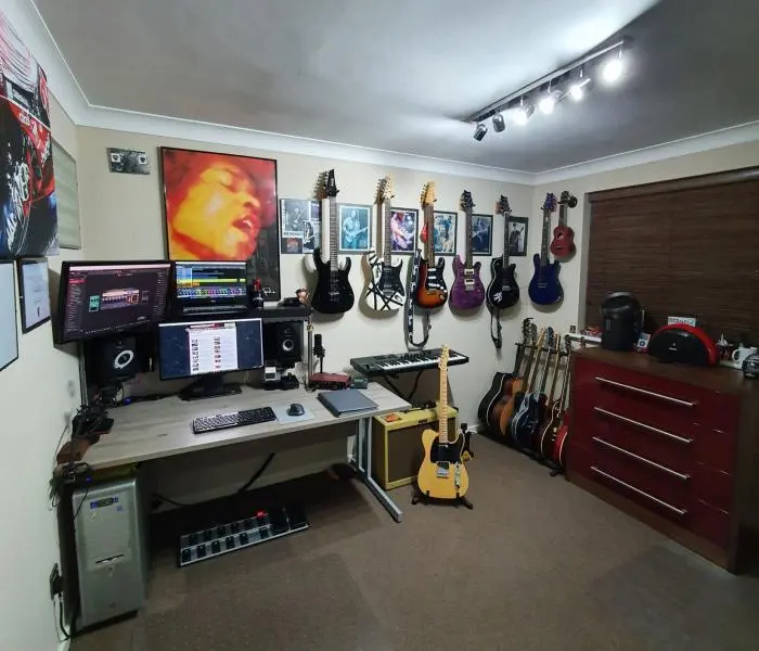

One problem I have is that where I took that picture from I the doorway to the room, to the immediate right is a wall of mirror sliding wardrobe doors about 9' (3 metres), I suppose I could hang a sheet in front of them, I have one of those backdrop things I could try. Also would it be better with the door open or closed? I could put some acoustic foam on the door but that's about it. Paul's room is completely dedicated to what he does, it's his day job whereas mine is my hobby. I'm not after professional results but do want to give him the best I can, within reason. He isn't asking me for better, he just needs to hear what I'm doing. Some of the video submissions I see submitted are very very lo-fi and he doesn't complain.
Thanks for your advice, I'll try one this evening with guitar reverb off on the amp sim, I'll angle the mic 45 degrees towards my face, does it matter which way the slots in the side of the mice are orientated? and we can see how that sounds.
I really appreciate your help, thank you. Did the video help or is a sound file enough? Below is a picture showing more of the room, the guitar wall is about 11' (3.5 metres) and the window wall is about 9' (3 metres).

Remember with a shotgun mic, it's going to hear what is directly in front of it. It's designed to reject the sound coming from the sides and back. If the space behind you is fairly dead, and the mic is pointing at you directly from the front, there will be less sound bouncing back towards the front of the mic. Something as simple as a thick moving blanket behind you can dampen some of the high and upper mid frequencies. It won't do anything for the lows, but if you are just working with voice, then you aren't dealing with lots of frequencies below ~120Hz unless you're James Earl Jones or Melvin Franklin! You can rig up a couple of boom mic stands and use the blanket as a backdrop if you are concerned about appearance. Or add a few hooks to the ceiling to hang the blanket. It all depends on your situation. Ideally you would make some permanent acoustic panels to hang on the walls to control the sound, but some people have restrictions that prevent that from happening.

shotguns are terrible microphones to use on stands because they need very accurate pointing. If you mute the guitar and listen only to the shotgun, what do you hear. Your voice, and probably you will hear you talking to yourself, when you should be talking up, like you would do if you were in front of a class. A teacher, in school would never talk at your volume, and the people on your videos certainly are not talking like you did. Audio is all about signal to noise. Shotguns have a nasty problem where they work a bit like a torch. Imagine yours as a torch in a darkened room. They will light you up, but also whatever is behind you. If that happens to be a wall or another reflective surface, the mic hears that too. You need the mic as close as you can ge5 it, and the reflective background as far away as you can. This is why video folk always struggle with shotguns indoors. You also need to realise that shotguns are only shotguns up top, at lower frequencies they are much more cardioid, so you can filter away LF with EQ, carefully. Your space has loads of hard surfaces, so record a single handclap and listen to it carefully. A simple duvet, held up on a couple of boom mic stands can really tame a rooms sound. Your room appears to have no soft surfaces at all, so that’s five reflective walls and a lightly carpeted floor. Asking your friend just gets you the solutions that work in his space, yours will be different. In my video studio I can use shotguns, cardioids or really anything. If I record in my office all my shotguns sound pretty terrible. I did a video with shotguns in the office which might make more sense.

My guess is your room is just not yet letting you find the correct place to put a mic, for your voice. You sound quietly spoken - so that would dictate a need for a closer positioning, and maybe an overhead position is never going to work for you, in your space. Before you sell that 2020, I'd strongly suggest experimenting with it in all sorts of positions. Mics in shot are very acceptable nowadays. Alternatives would also perhaps be to try a lav style small/miniature mic clipped to you. That would not be seen and might sound better, although these of course are usually omnidirectional so won't have any ability to reject the guitar. However maybe you could use in-ear monitors for the guitar? That would certainly make the room sound less tricky to balance? I think I'd get a nice duvet in and experiment with that as a simple way to remove some of the reflections - on voice, they're quite effective.

I would do what you suggest - with an addition. You need to experiment with distance from mic to mouth and also where in the room, that combination is, as in close to the walls facing in, further away facing out and even perhaps spinning around? I think you want to concentrate on the video - so use your phone to shoot yourself in lots of positions, rotations, angles and with the different mics. Make sure the audio recording can be edited to the video like you might do for the YouTube video - so just clap your hands at the start and just align the phone and mic waveforms - it's a very simple process no need for complicated software. Line the claps up and away you go. Generally 6" to maybe 2'6" gives a similar tone to the sound. Go closer, and the proximity effect you mentioned starts to appear. Remember there is nothing wrong with it - because the extra bass and warmth can easily be EQ'd out, but the problem is simply that small head movements start to change the sound considerably making management of levels and tone difficult. further away than 6" and it really is just volume.
Don't forget that if you track the hollow sounding recording down you could find it's a wall surface reflecting back into the rear of the mic. Cardioids don't have a totally dead rear , just a vastly reduced one., so sometimes a mic pointing at your mouth from the side can work pretty well. Recording lots of examples and making adjustments is great - listen on headphones you trust so the room doesn't add to the result like when using speakers.
