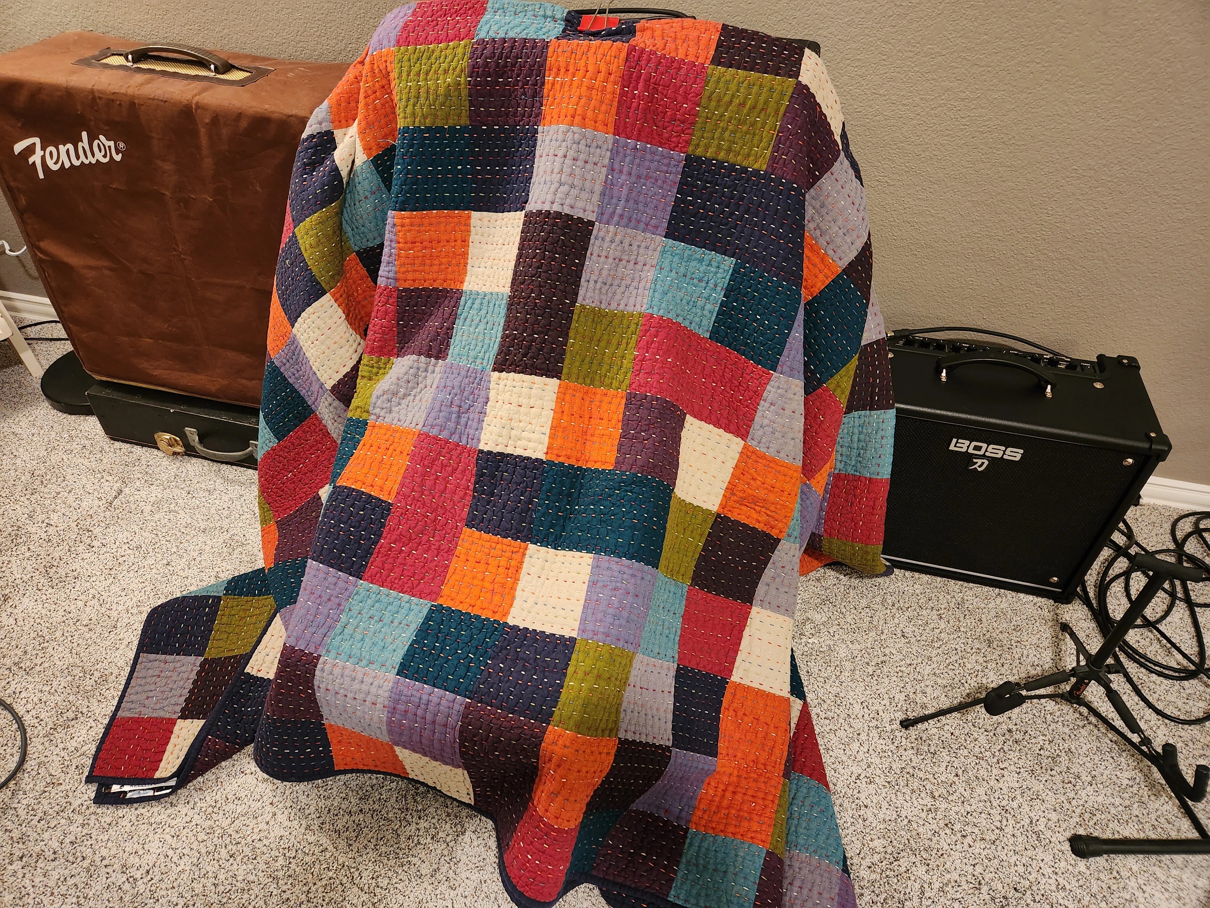

Regarding mic'ing an amp in a small room with poor acoustics - a great way to deal with this is to get a couple of short mic stands to point the mics where you want them - and then draping a double or triple folded large blanket, quilt, or comforter over the front of the amp and mics. It only deadens the volume a little - but it will kill any ambient acoustic issues.
Looks something like this:

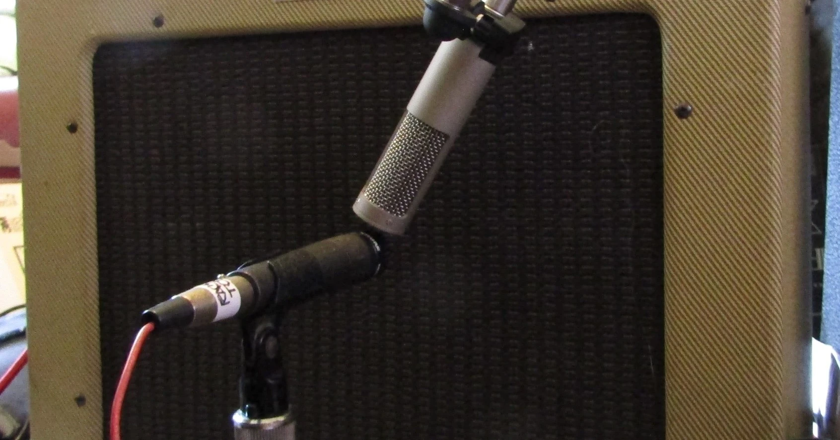

I love an sm57 with a Beyerdynamic M160 hypercardioid ribbon on a guitar cab in my small room. They are very complimentary. The M160 rejects a lot of room sound unlike many other ribbons. It’s also less expensive than the R 121. The 57 is the bite and sizzle, and the m160 is the meat. Look into it, so good! This combo is used in lots of pro studios. I tried a Sennheiser e609 with the sm57 and was very disappointed. A 57 alone just doesn’t bring the weight. Sm57 + M160 for the win for me!
Note: pair the M160 with a Royer dBooster because a ribbon has so much less output than a 57. Plus, it protects the mic from phantom power.
