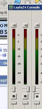

OK, first of all, what version of Windows are you running? The Layla control panel for 98 is not as detailed as the one for XP.
But anyway, for each input you should see a meter. These meters are grouped into L/R pairs. Right under the meter is a pan slider and a little button that has an 'm' on it. That's the input mute control. Unmute channel 1 and slide the pan fader so it's in the center. You should now hear in both ears.
Here's a screenshot if that helps...
madaudio,
thank you so so much, that's a big help--i have XP--and i was able to do exactly what you showed. didn't have time tonight to hook up the preamp, but i'll probably try it out tomorrow. i'll let you know how it goes. again, thanks.
