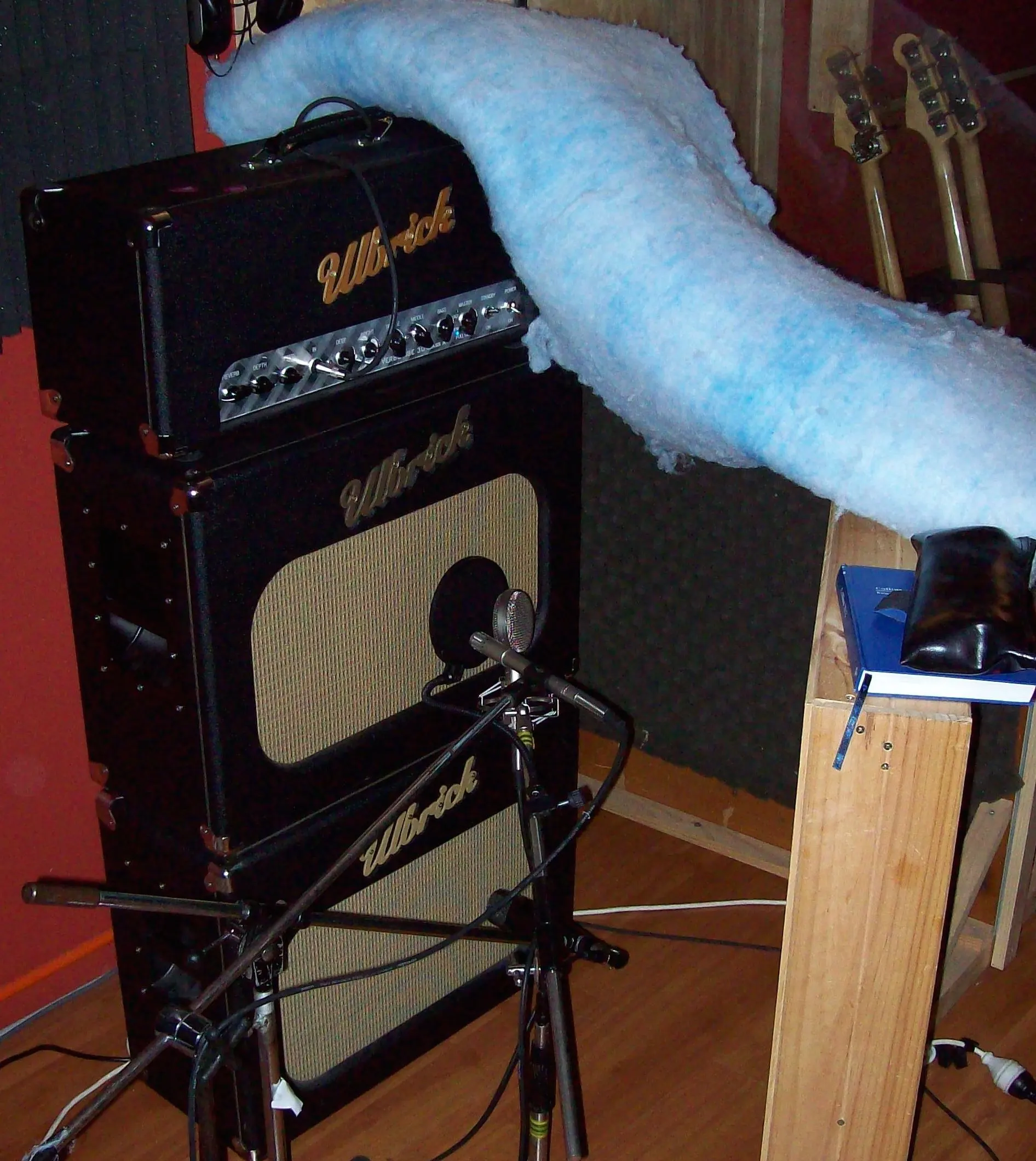

This is how I miked my guitarists amp when we recorded the last album, all close kicked as we played the tracks live, guitar, bass and drums.
There is a fathead ribbon, a sennheiser ME20 omni pencil condenser and a Sennheiser 421. The 421 sometimes was swapped out to a sm57 depending on the track. All mics going to separate tracks on the recording.
Alan.

You use a pop filter recording a guitar cab?
You definitely do something about that big blue slimeworm in your studio! :eek:
You got a midget singing in that cab? What's with the pop filter?
The pop filter is to reduce the air blast on the ribbon mic, I have modded the screen mesh on my ribbons so they are not so restrictive, but with the volume of the cab there was some air pop problems with some low notes in this case.
The reasons for using multi mics is that I can use 1 or more mics later to get a guitar tone to suit the song, as we tracked 10 songs over 3 days and I was also playing live (bass) while tracking.
Oh and we had the midget backing singers in the cab to save room.
Alan
