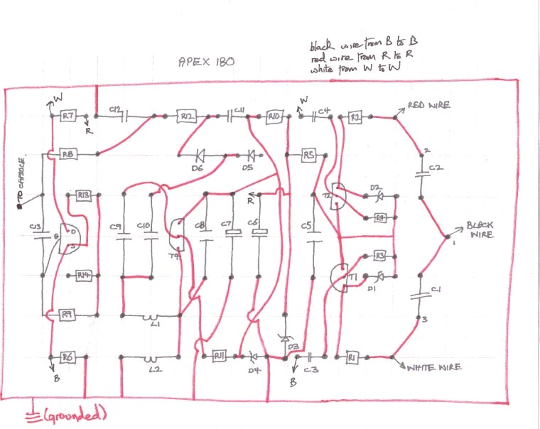

Hi,
i did my best to draw out the board.
The red lines are the traces running underneath the board.
Ask for any of the values of the components and ill post them.
Any input on what may be worth upgrading on this apex 180 mic
is appreciatted.
Thx, A

I'm no pro, but I would say start by upgrading C1, C2, C13 to higher-quality caps.
It looks like the circuit may be doing some EQing. You may be able to "shape" the tone to taste by playing slightly with the values of the inductors and caps in the middle section.
Don't do anything until someone more knowlegable says so, though :)

I did notice a mistake in my schematic,
the RHS of R6 joins to the LHS of R14 and not to R9 as shown.
I have asked apex for the official schematic but have not heard back yet.

Andy,
Could you please check a couple things. Pin 1 (Black wire) should be grounded. I am still not sure about resistors R9, R13, and R14. R9 (it is a HiZ) may be whether grounded, or connected to R13-14 to provide additional bias for an input FET. One of them may be a trim pot (is it square?)
As I suspected, this is a very common schematics, based on Schoeps circuit, and can be found in many microphones, such as MXL603, 990, 991, 1006, 2003, SPA-1, Rode NT2, etc.
Sorry Bleyrad, there is no EQ section, but there is an oscillator to raise capsule bias on transistor T4, and the caps to replace are C13, C3 and C4. Instead of C13 use 820--1000pf polystyrene. I suspect C3 and C4 are 0.22Mf cheap ceramics--use polypropilene 1Mf, instead. If there is room, try even 2.2Mf for better bass performance. If you don't have RF problems, you could try to remove C1 and C2, and put jumpers instead of resistors R1 and R2. Also you can try to replace D1 and D2 with 100K resistors and see if you like it.
These very simple modifications should give you considerable sound improvement. Please report your impressions.
Good luck.

First, yes pin 1 is grounded its just sneaky.
Resistor R9 is large brown oblong with 1 km writen on it. Not a trim pot in sight.
I did mess up the drawing a little around this area and will repost the correction when my scanners working again.
I will post my observations as soon as i can.

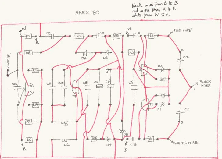

Hi,
i updated the schematic I did, thx to everyone that replied.
I was wondering about the caps that need replacing, c3, 4 and 13... they look like they were sealed by dipping them in a yellow plastic, is it possible to identify them from this?
Also they have the numbers 224, written on c3 and 4, and 102, written on c13, i know that these are the uF values but could someone explain how tha system works.
Thx

Andy,
These are very cheap ceramics and SHOULD BE REPLACED. Once again, use 2.2Mf instead of C3-C4.

Replacing c3 and 4 with a higher value cap, it seems theres a 0.22uF in there rightnow, will have what effect. Im just curious.
Finally, is there any special cap thats good for this and what voltage rating should I be going for.

Andy,
The 2.2Mf value will improve bass response, lowering the low frequency one oktave down. I like Solen caps, which have very good value for money and are not terribly big. I got them from Antique Electronic Supply (when I lived in Tempe). Google and you will find many suppliers for them. They come in 250V and 630V rating. Use 250V. First, check if they fit, though. Also, I like Kimber Caps a lot, but they are more expensive.
