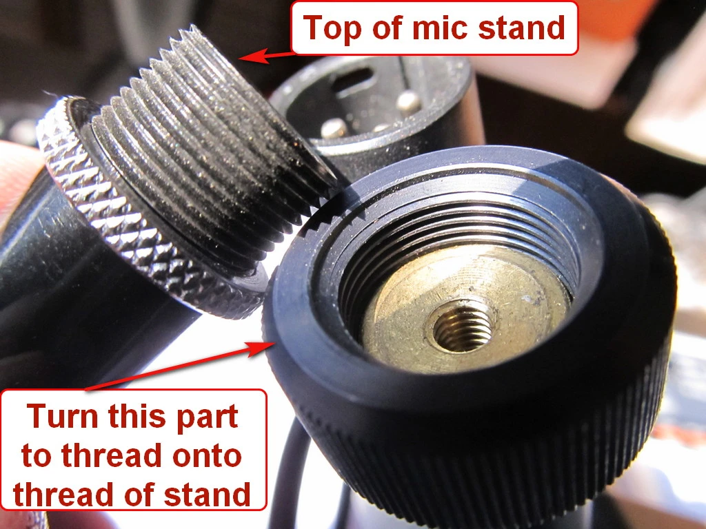

I can't see the top of your stand clearly in your picture. Does it have threads like shown below? The 'collar' on the SM7b turns and should thread onto your stand until tight. Be careful not to 'cross thread' when starting it.

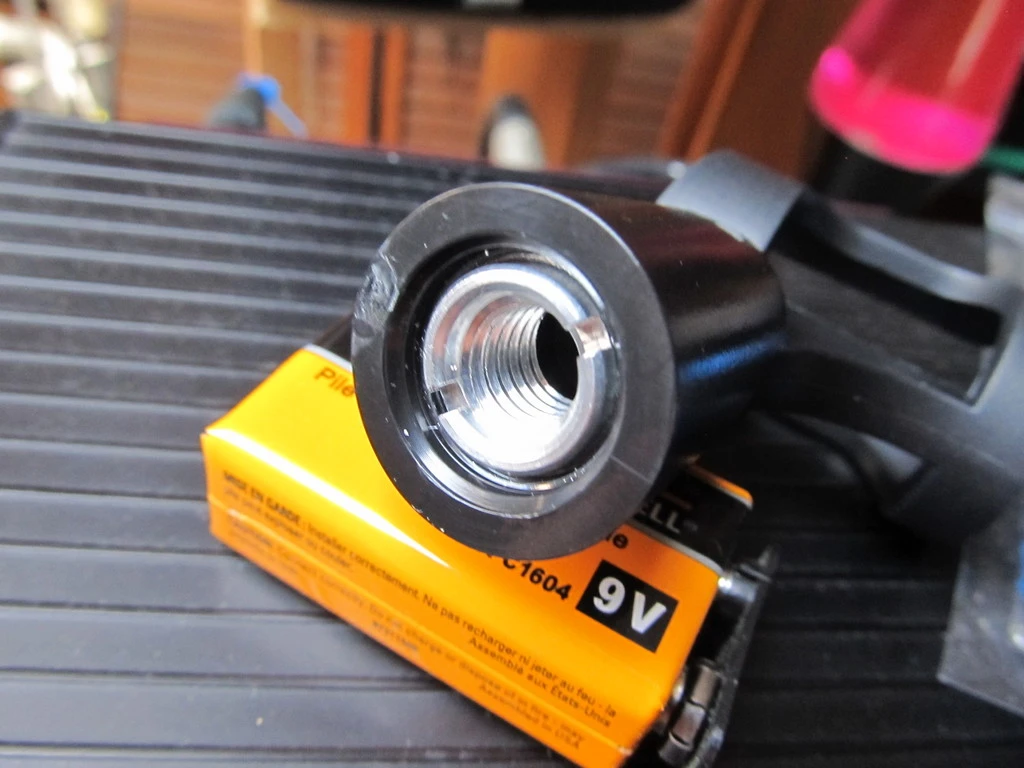

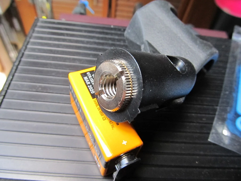

The inserts Gtoboy mentioned will look like either of these to fit a 3/8" SAE thread. They can be removed with a coin that fits in the slot.
