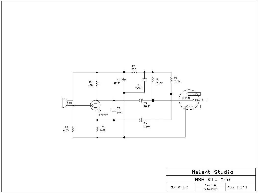

I mess with home built speakers and measure them and I like to experiment and build projects. I thot it would be fun to try a mic system that had an internal pre at the mic and a buffer/gain stage with level control at the computer and the ability to swap out the mic capsules. Looked around and found Niant Microphones site. Check out the X-R version. It is ideal.
On that site they publish a pre that can be built in an XLR plug. It is what they call the basic circuit. It is under About/Microphone Design. Look for basic circuit. Here is a pic
Pretty simple and very small with no special requirements. Nice!
Now what I need is a simple circuit that can take the balanced out from the pre, supply phantom power to the ECM, convert the mic signal to unbalanced for my computer line-in (I need to go to line-in for my analytical software) and have a level control as well. I am pretty sure that can all be done with one op amp in a bitty box near the computer.
I will not be recording, only measuring. Can anyone point me to a circuit that will do the buffer/amp/level control job? Got one handy?
And, no, I do not want to use a mixer, etc. I have one for my Behringer 8000 and want to make up a simple buffer/amp/level control as a project. Suggestions?
BTW, the Panasonic WM-64P might be an ideal ECM to experiment with. Sorry you will have to look it up. But is sure looks flat and the FR should extend flat to below 20 Hz. And they can be bot real cheap on eBay. 10 for five bucks. Cheap enough? Search for WM 64P on eBay.
I already bot some so can someone help me out?
