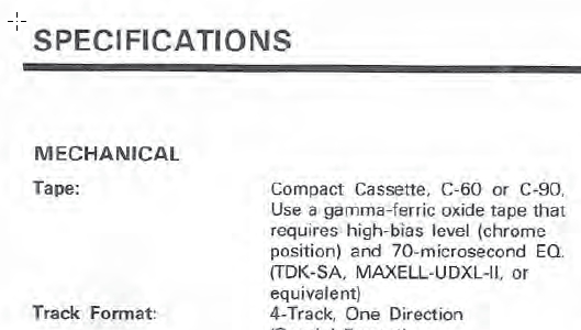

Well, first of all, the new tape you bought (UR 60) is a normal bias tape, which is already an inferior tape to the XLII 90, which is a high bias tape.
If you look in your 244 manual, I bet it advises against using normal bias tapes with the machine. Actually, I just took a look through it. Although I didn't see anything about it in the instructional part of the manual, it does mention it in the SPECIFICATIONS. (See attached.)
So ... normal bias tapes in general are not fit to record with on the 244; it's definitely recommended that you use chrome type II (high bias) tapes for the best quality. That said, I don't think it should be warbling with a normal bias tape. If the machine works fine with the XLII90, then I think you must have gotten a bum tape in the UR60.

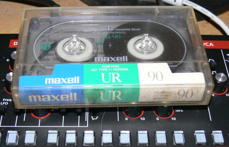

I snagged a box of ur-90 about 6-years ago, and felt the same way. That's mostly on two decks, though. There's nothing wrong with buying used tapes and erasing them with a bulk eraser..
Back then, I mostly used TDK AD, but if you can find these, check 'em out

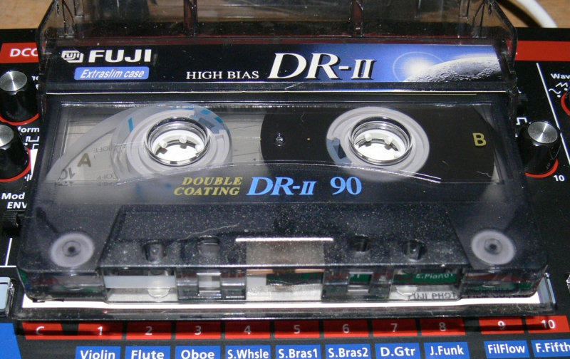

Oh, I'm Buying Fuji for Type-2 tapes.
