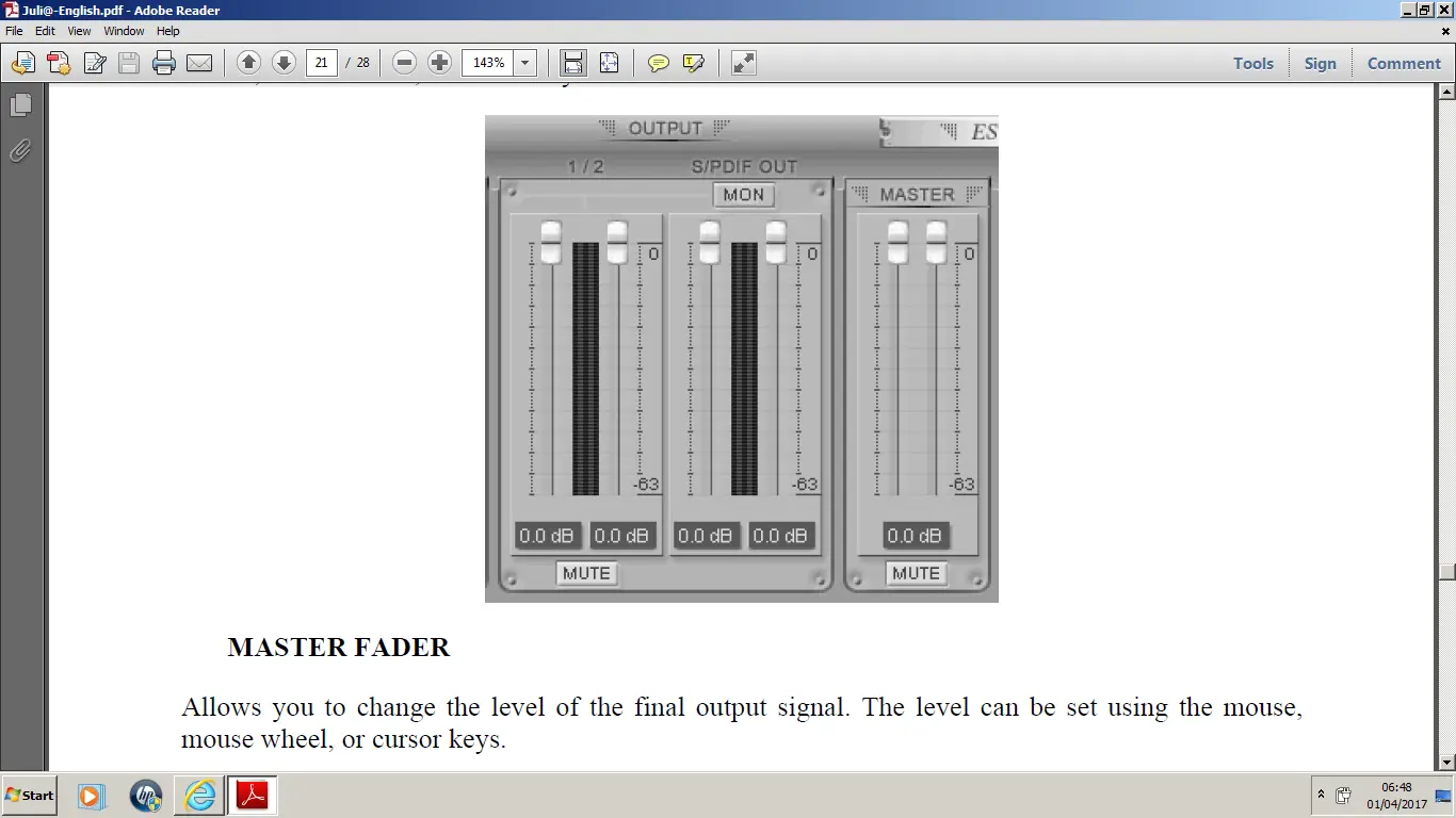

Attached is the output control panel for the Jul@ card. The "faders" can be seen to be at max (0dB) by default and indeed they are so set for all other views of the control panel.
You can of course overload the card's INPUT but this is under the control of whatever the sound source is, e.g. a mixer.
To tie it all up: Record 24 bits (44.1kHz unless you like buying hard drives) and average as Bob says at -18dBFS, even as low as -25dBFS will not hurt if the program is beyond your control, a live band for example.
The "mixer" in the DAW software should default to "0" with the usual +10dB available on each channel. I am NO mixer! But I believe the process should be more "subtractive" than "additive"?
Control the card's output with an analogue device, i.e. a pot in a tin.
This, ^ all assumes ASIO drivers and control by the soundcard and the DAW. If you let Windows into the equation all level settings go to H in a pram!

The volume control on the soundcards control panel should be set at 0 (unity) and never touched again. If your mix is clipping, the master output in your DAW is what you need to bring down. If the signal is clipping in your DAW, the soundcard control can't fix it. It will simply lower the volume of the clipped signal.

I did some digging on Pinkertel's setup and found that the Juli@ card is modular and can run at +4 or -10 levels by swapping out modules that have either RCA (-10) or 1/4" TRS (+4) connections. Not sure if there is any other way to switch operating levels. I can't find any specs on the Hercules speakers, but they do have RCA and 1/4" balanced connections. One would think the balanced connections would handle a +4 signal but it didn't get mentioned in the manual. Suggested uses are for TV's, computers, home theatre.

It shouldn't be that complicated. The Juli@ specs are actually fairly detailed regarding RMS and peak voltage for the respective modules. For example, the consumer module does not output upwards of 3 volts peak. The balanced one does. Since Pinkertel said he had to drop the signal around 15 dB so the speakers didn't kack, I'm thinking it's a consumer level thing.
