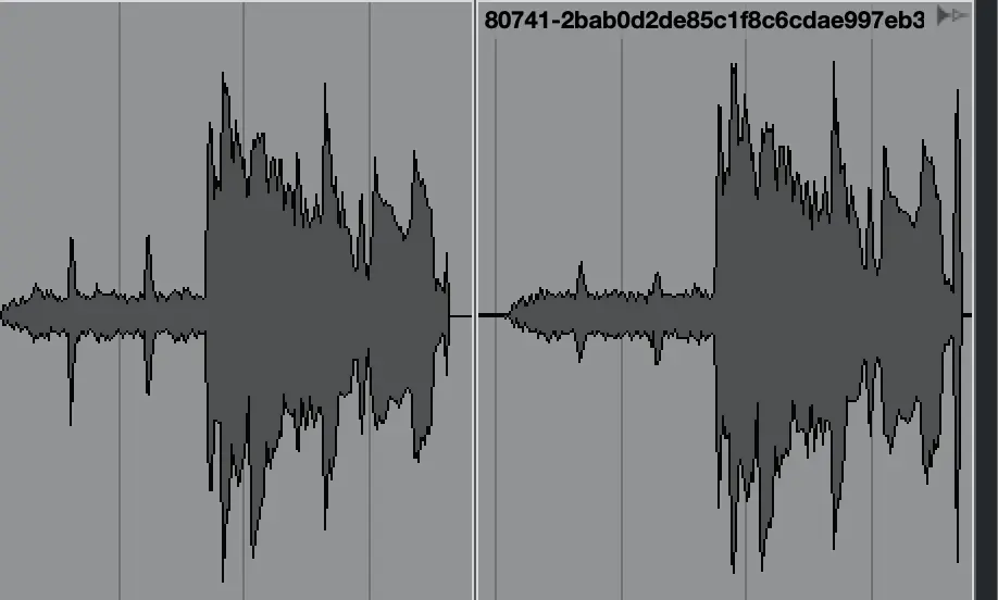

First was loud and I had to pull my IEMs out. I turned the level down and tried again.
I normalised the two and compared them side by side. I see the hats at a much reduced level, and a few other compression artefacts, but apart from the hat being low in level, one does NOT jump out at me as being worse in quality - just different. On balance - I prefer the squashed version I think. The other is for my taste a little too wide in dynamics and because of the unusual arrangement and syncopated rhythms - you get the piano, bass, drums and the brass as four totally separate sounds, and in the squashed version they blend a bit more. I really don't hear the distortion you do I'm afraid. Just mild changes due to the different compression used. I think for me, the first version is simply too loud to suit the music. The muted laid back trumpet just doesn't work really loud.

Thank you for analysis Rob!
Different in a way that it's missing crisp and high frequencies, do you mean that? Maybe I'm judging too harsh on it, and I by no means have great ears yet, since I'm just starting out, but the difference that I hear is just unacceptable.
