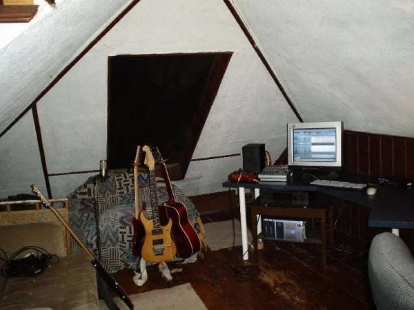

I went totally ghetto at first, I bought an old Kitchen Counter top for 20 bucks, found some legs at the same place for 5 and voila, my desk.
Here's an old pic, it's changed a hell of a lot since, ( for the better thankfully ) But at least you can see the blue formica in all it's splendor.
