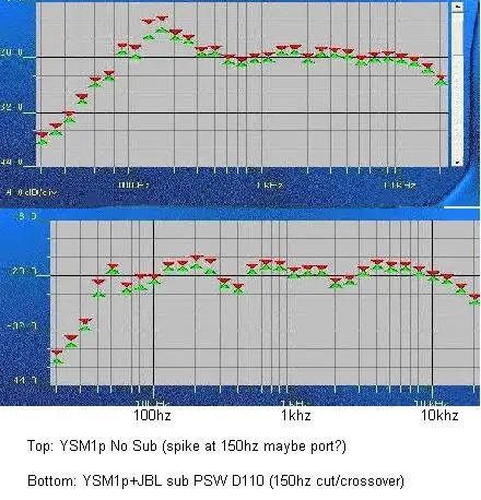

in my last smaller HR room the 6" speakers got to approx. 150hz and start falling.
the sub fills it in, but I noticed to make the mic and spl stuff happy the sub was hardly obvious, invisible almost.
i think with the foot switch it would make it like a Tracking Full range to a quick no-bass "NS10 no bass hifi 4" speaker type" check...
I'd have to play around but I'm thinking a higher end cutoff than the anechoic chamber specs suggest?
here's an old plot I did from a smaller room with the YSM1p....its not high resolution, but hey....it was a free trial RTA I did myself. No Bob Hodas here..:p
just add a note- I had approx 10 703 panels from Ethans DIY stuff too..

Nice graph after the sub was put in. I have yet to do that here to see what the end result is as far as room response goes, likely this weekend. The footswitch is a seriously cool feature. It's really almost ridiculous the difference it makes in my studio.
Cheers!
Way ahead of you...I have 4 8'tall 4" thick bass traps in the main corners. I have a 5'x4'x4" wall panel trap on each of the long walls as well. Above them I have a 2'x4'x4" wall/ceiling trap and a 5'x4'x6" ceiling cloud above my mix position. Believe me, it's the monitors...
