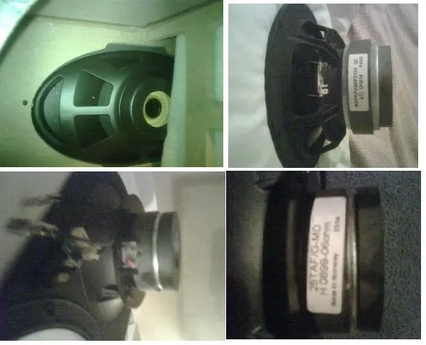

Mackie HR824 speaker removal US and China
Ok, I got the damn cabinets open.
FYI for anyone doing this someday.
1) You need the T screwdriver...not a standard screwdriver.
2) The Faceplate is very difficult to lift up. I worked around the bass/bottom two screw holes. Prying gently the face plate lifts. The woofer stays in place while the metal faceplate can be lifted. The tweeter will stay with the Metal faceplate.
3) The cables require unplugging! this was tricky due to the short wires....needle nose pliers.... unplugged the ac c0nnector and the speaker connectors.
4) Recommended....once you get the speakers and face plate out take the foam baffle out of the tweeter side and you'll find the wires rolled up and tie-wrapped. I cut the tie wrap and this allowed for plenty of wire length. (obvious they build this from the back initially!)
Anyway....took some pics and may have some more.
But again the US vs China myth was a washout...bullshit....both speakers Identical!!!
and state on the label MADE IN NORWAY.
the woofer info. MSPKP22WP2104 QC 4ohm DPB35 (both the US and China built)
the tweeter 25TAF/G-MD H0899-06ohm made in NORWAY...
US dated 25/04
China dated 23/04
posted some pics, the passive radiator with the speakers removed...a couple blurry shots of the speakers....notice the one shows the metal ring, that was a surprise when taking the speakers out.
so if some hear a difference in the amp and speakers....ok.....:rolleyes:

Not exactly all that mis-matched after all; both from the same factory in the same month. Glad to see the GC sales guys got their story right yet again :rolleyes:. "M8" is a legit factory code, I've seen it used before, but I have no information breaking down which factories the various codes represent. If you really felt like tracking it down, I'll bet ya it could be had for the asking at Mackie's support forum.
