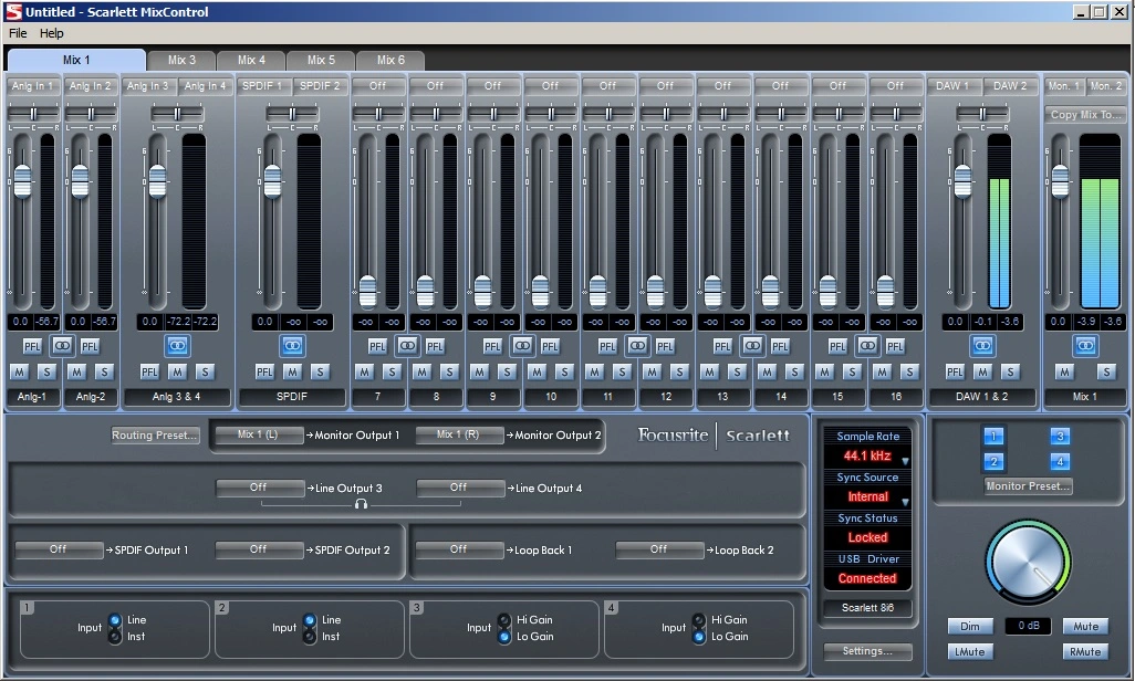

Here's a screenshot of the Scarlett MixControl window (the software mixer for the interface):
If anyone has any suggestions it'd be greatly appreciated!

Well, looks like Analog 3&4 are linked. You don't say what your inputs are. Are you recording a stereo input like a keyboard? Or are you recording a mono input like a guitar or mic? If the latter, unlink the channels.

In your screenshots, what are DAW1 and DAW2?
Also, why are you using a mixer with the interface? Not really necessary. Can you remove the mixer from the chain and see if you still have problems?

DAW 1 and DAW 2 are the outputs from your DAW, so in this case Cubase, channels 1 and 2 (which you can change in your DAW).
