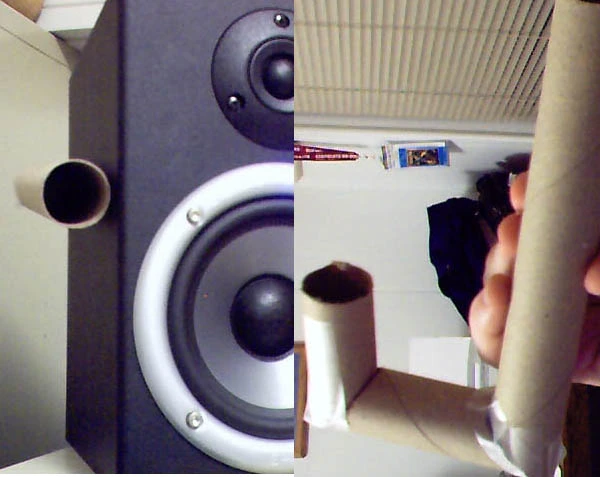

..how did the plastic tubes experiment work out?

You mean these? Had to make them out of cardboard but yeah they work. They push the bass around the front. You gotta get use to them though but it helps not to overemphasize the bass in the mixes. What do you think? Should I chrome these babys?

Actually I need to improve on the design but the SP-5B speakers are producing plenty of lo end that you can't hear acurately because it throws out the back. I need to find some hose that is exactly the same diameter of the rear holes. These cardboard ones work for now and it improves the clarity in the mix at the 80Hz to 350Hz range. Once I find some flexible hosing to replace this prototype it should be even more accurate.
Looks good, considering the materials you're using. You may be able to find some auto hosing to fit. I'm still considering buying those monitors and from what I'm hearing in this thread I guess I should go ahead and get them.
thanks for the pix.

Just for those who may go down the tube extensions path on the bass port. This may not be such a good idea and here's why.
Those bass ports also dissapate the internal amplifier heat. I upgraded my tube design with PVC tubes. The bass port size is 1 5/8 inches and when I builit the tube rap around I noticed a lot of heat coming out of the tubes as well as the bass frequencies. Using the tubes could back up the hot air in the speaker enclosure and cause problems. I took off my modification to avoid potential problems.
Thought I should pass that one along as a potentially disasterous modification. It does work however, and you get a much better idea of what's happening at the low end. Not worth risking having to purchase new speakers though.
