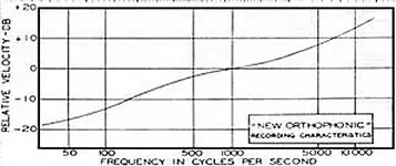

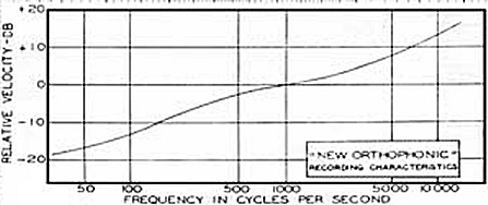

See attached.... but the results also depend on how the cartridge is loaded (impedance), so I don't think it's quite as simple as straight EQ..... Note - the image shows the RIAA EQ curve that get applied to a vinyl master -- you invert it for playback.
