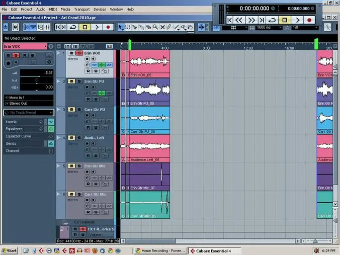

Here's a visual of what happened. Everything between the green lines should've been one file. When it stopped recording, I lost everything that's not there now. And what's weird is that around the 4 minute mark it just changes songs in the middle of another song like it merged the files somehow. :confused:
I'm hoping that it's not gone forever, but if it is, that's just life I guess. You live and learn. :o
