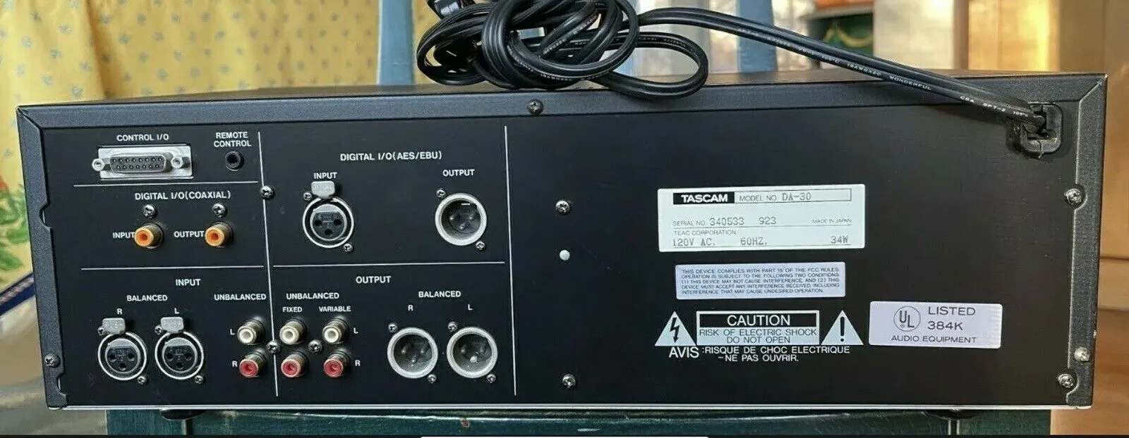

I just restored my Tascam DA-30 (have numerous production tapes which need hard disk transfer). The Dat Machine has 'Coxial' or 'XRL Digital Output' - Have noticed there aren't many options on the market for PCIe 'Sound Cards' with 'Digital I/O Coaxial' input? Can someone possibly offer another option/idea? Is it possible to adapt from Coaxial (which naturally looks like RCA) to possibly another configuration? Like maybe 1/8 " Mini Stereo? Which most of the Sound Cards feature. But of course I need Digital to Digital (keeping analog out of the equation).

Take a peak at the image (Rear Configuration) Tascam DA30
Just to 'clarify' options and capabilities: The Tascam DA30 already has analog out (balanced & unbalanced thru preamp). If preserving digital quality was not paramount, I could simply 'adapt' the Tascam analog RCA output to Mini 1/8" Stereo Male and feed that into my current Asus PCIe sound card input. Occasionally I use 'Audacity.' Of course its still only 'Line In' but seems to work reasonably well when I take 'Line Out' from an older Mackie Analog Mixer.
